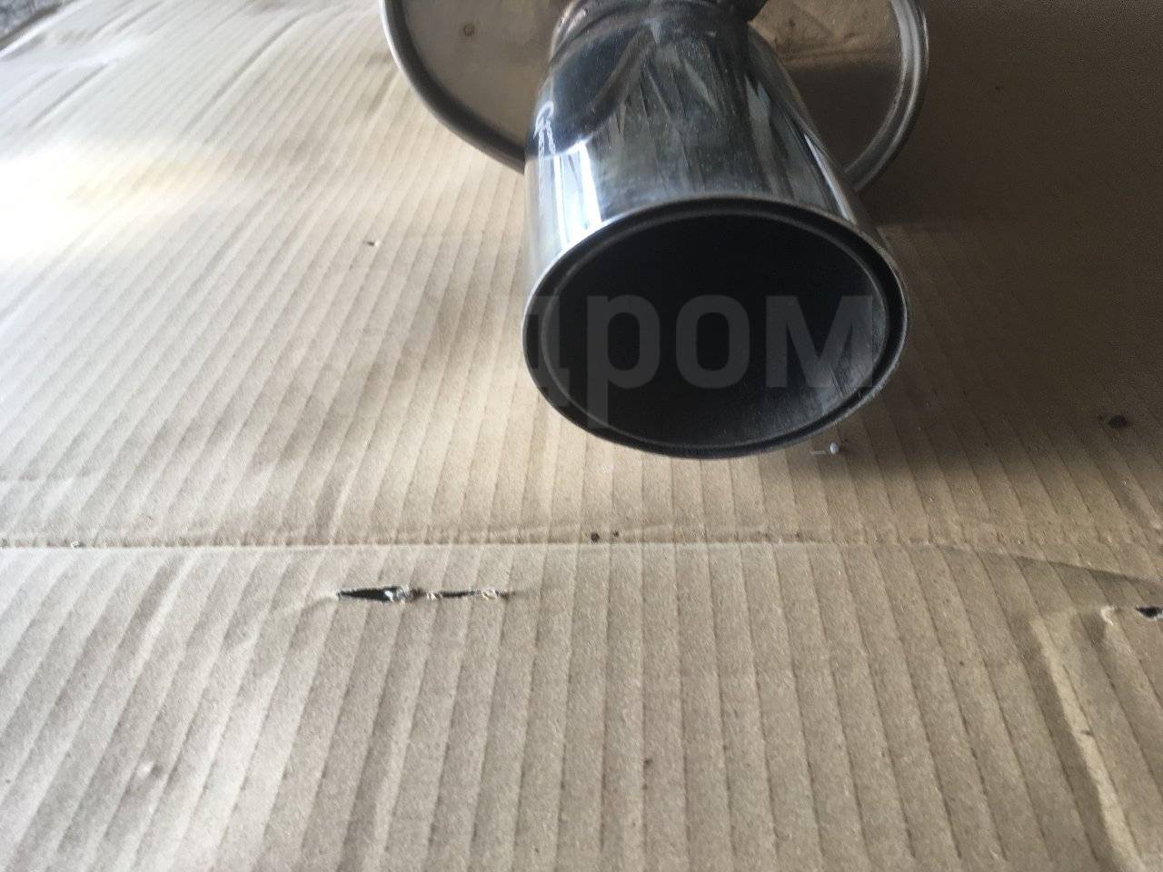

I think I found a possible reason why my Tanabe exhaust is louder than it should be. I found a sales advertisement for the same Tanabe Hyper Medalion exhaust on a Russian site. This is a picture of the exhaust tip:
[Image: AEU86 AE86 - Exhaust replacement]

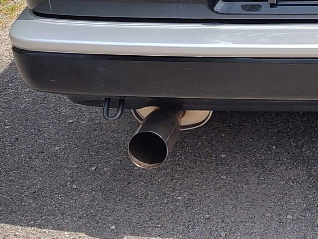

And this is a picture of my exhaust tip:

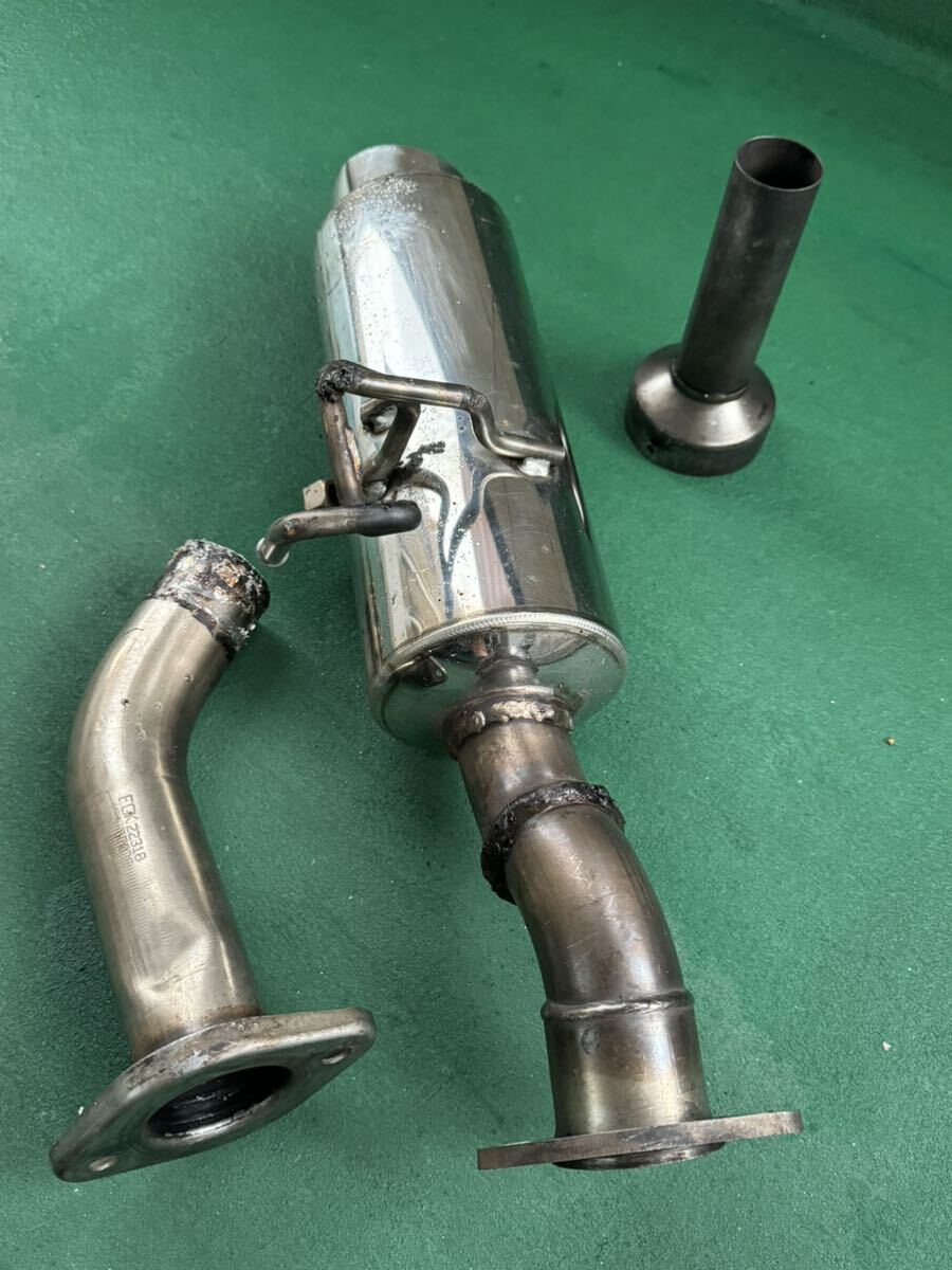

I've seen a similar thing on some of the other Japanese performance exhausts there is a funnel-shaped part that you can take out of the exhaust tip. For example, this Tanabe exhaust has such a funnel:
So I'm wondering that if my car is missing this funnel, could that be the reason why it's extremely loud? Or is it actually the other way around and the funnel bypasses the second silencer? Dumb question
08-19-2024, 01:00 PM
Exhaust replacement
Those funnels are an additional silencer. Many remove it as it also changes the tone of the exhaust.

Thanks for confirming that. I think a previous (Japanese) owner removed it and never put it back on the exhaust. Next time I'm at the garage I'll make better close-up photos of the exhaust tip.

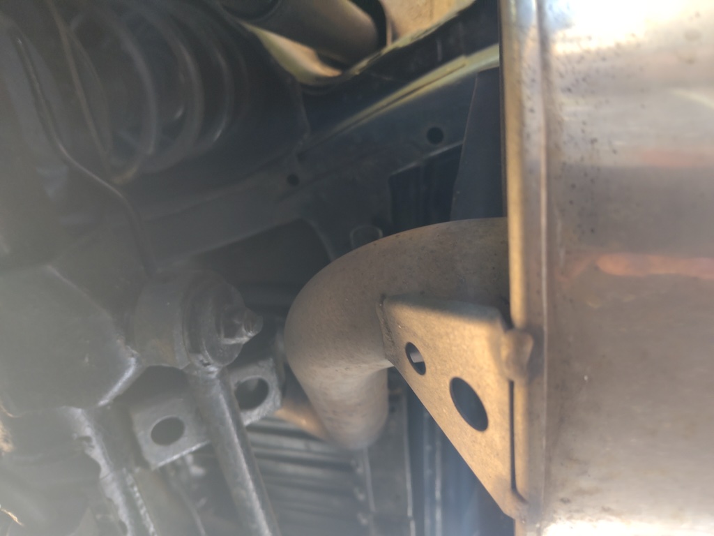

I had a look and at first, I couldn't find a hole that's capable of mounting a funnel on. But then I found this on the side:
It looks like a spot where you can mount something on the exhaust tip.

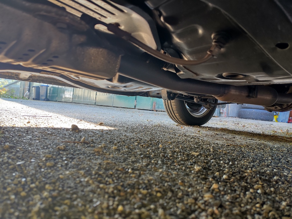

Whilst I'm busy with it, I've taken some photos of the exhaust system as a whole. The exhaust is an over-axle design and, except for the stainless mufflers, appears to be mild steel:
The exhaust system appears to be in a very good condition and I didn't see a whole lot of rust on it.
