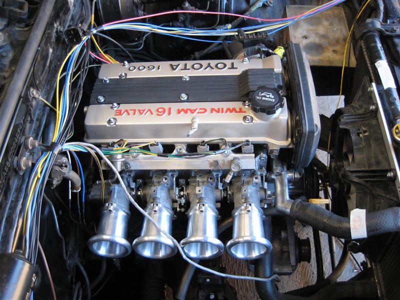

My engine specs:
4age 16v smallport
Stock pistons
Stock valves
Stock injectors
Lightly ported top - head has NOT been shaved
0,5mm TRD head gasket
Sqeeze area modified to ensure room for pistons
CR ~10,8
Silvertop ITB
Custom inlet manifold
Catcams 7105137 260 / 252° 9.00 / 8.50mm
MS1 v3

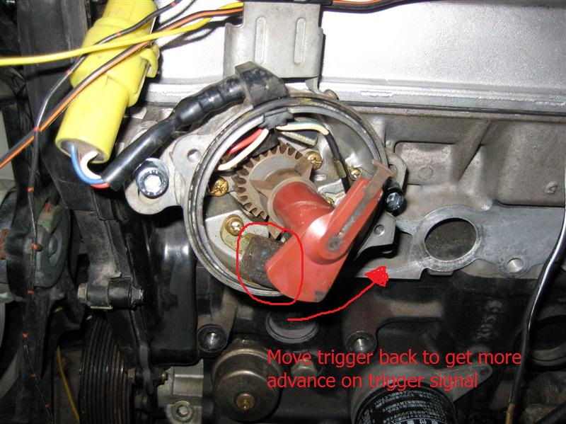

I still think the problem is the physical position of the ignition trigger positioned only 50degrees BTDC. I know of another guy that has moved this slightly within the distributor to get enough advance. MS manual clearly states that you should NOT run 20-50degree advance in the software as this migth cause problems. Anything else that can delay the ignition? The trigger wheel has 4 teeth. Can you just add 90degrees in the software and then get the trigger signal at 140degrees BTDC?
We did experience problems with an unstable LM-1 on our lats trip to The Ring, but this would be easy to disable and eliminate as a problem.

from what I've seen on MS the OEM setup regarding triggering should work as it is... if the neccesary adjustments (soldering) have been done ...

If you think the trigger wheel is the problem.
Build a new one?
We did that on our turbolaurel and on a S14. (dont have pics of the S14 though. Searched for 20 minutes. lol ^_^)
[Image: AEU86 AE86 - Exhaust gets REALLY warm, m...running MS]
Do you have the appropriate resistors wired up to your trigger?
