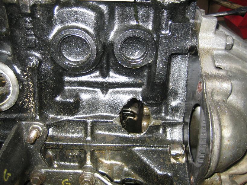

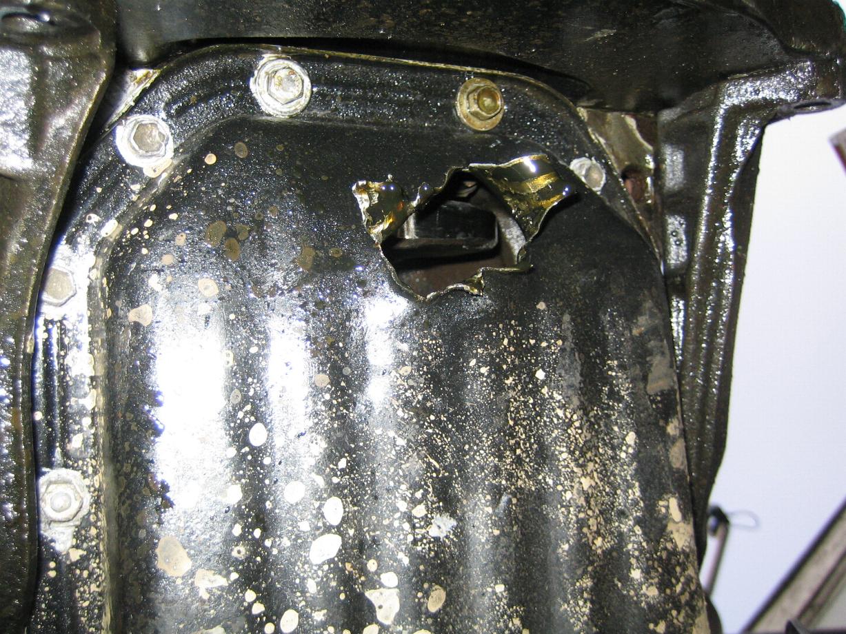

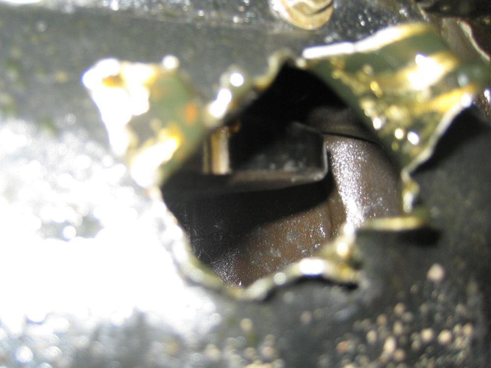

Hello ,
This my third engine break this year (rally season) .
And I think the worst .
2 1/2 rallye for this one , let's say it's about 450km special stages .
Just got the engine out of bay , and pics are speaking for themselves.....
Just notice the pictures comments , thanks to Pink Floyd !!
I'll try to make other pics , during the the taking aparts operations ( but why opening it ?).
My newyear occupation is known now !
Filh

I'm not so far in disassembling , but I can tell that even the steering strut is damaged !!!
Looking through the holes I can see : a broken rod just blocked in the middle of cylinder , and piston is just above .
I guess I won't retrieve much from that 450km engine .
I rebuild that engine with new bearings everywhere , new pistons and rings ,
block was " rebored" 81,50mm.
Just don't know what happend and will probably never know .
No noise , no oil or water consumption ,a good oil pressure .
Lot of work now
Phil
