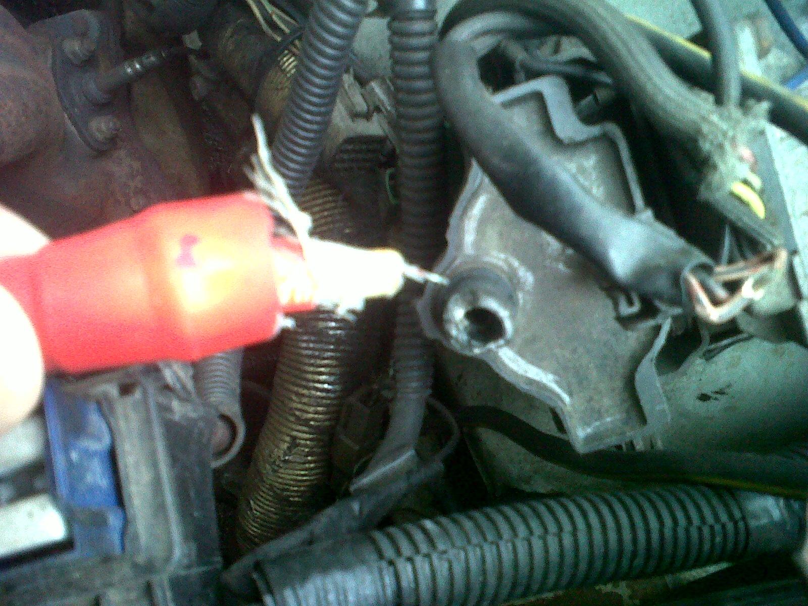

Guys this is the connector that's fu..'d.. What do you guys think? shall I expose a bit more wire?
Also what do you think of the connector on the coil?

Guys thanks for all your help.
The miss is gone now after mending the lead connecting to the coil and cleaned up the spark plugs.
