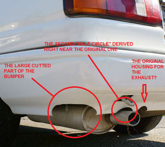

Scrolling the photos of the car I noticed that the exhaust seems to be slightly shifted towards the outer side (left), resulting in one more "half circle" obtained by the bumper as well as another one on the left side of the bumber, this time significantly bigger), I believe originally non-existent. You can see them by the attachment.
Is that an aftermarket work (and so any idea why it was done?) or what?

Looks like someone have deliberately cut the bumper to put the exhaust on the side.
As to why, you will probably have to ask the owner. But it's incredibly stupid to cut the rear bumper to do that (and it look bad...)

I agree with you, Project D, without any doubt an ugly work.
Thanks, I'll follow your advice and ask directly to him.

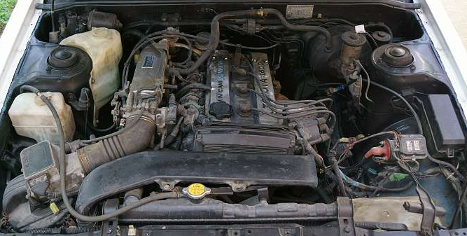

Now my doubts relate to the engine bay. I know that judging it just by a picture is absurd, but any possible thought about it will help.

Not sure if the cam case breather hose is just disconnected or if he ran it to a catchcan/ground.
Seems to me it's a bit like the rear bumper the person just made things work without taking much care. Just by the looks I wouldn't trust most of the rubber parts in that picture. Maybe it's just dirt but I think a lot hasn't been touched or cared for in the laat 30 years.

Ehy Bean, what a glance! The owner said he must fix the oil pump and the car is stopped since 2009. He said also the car was planned as a project for drifting.
If you were me, what questions/requests would you make?
One more question: are all OEM parts?

It does look OEM, as much as I can see.
Not sure what to ask. Personally I would just use all the bad points to lower the price a lot and then fix it myself. Always depends on what you can do and what plans you have for the car.

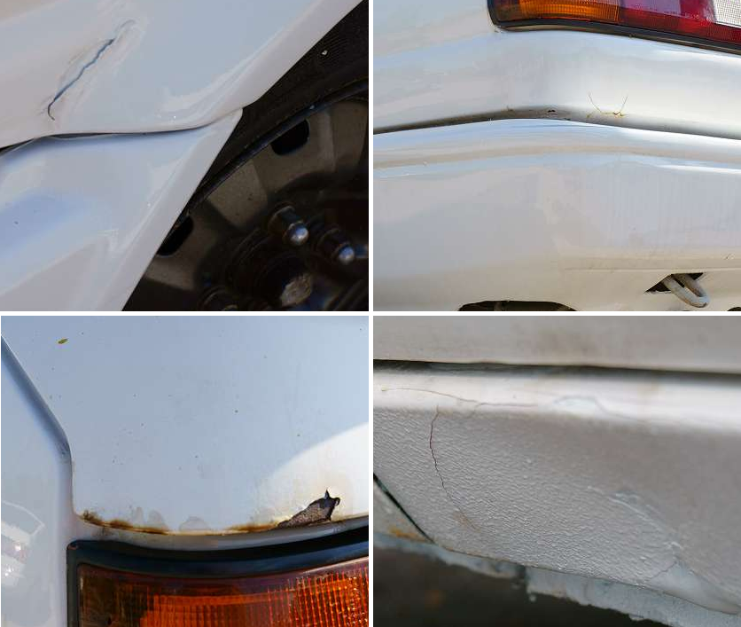

In this case, I would take the opportunity to ask you an opinion about the rust in the attached: what do you think about that and could it just on surface?

Regarding the rust the lower left picture looks to be more serious and tricky to fix.
The others I can't tell by the pictures might be surface rust underneath or more serious - only way to tell is to dig in there.
