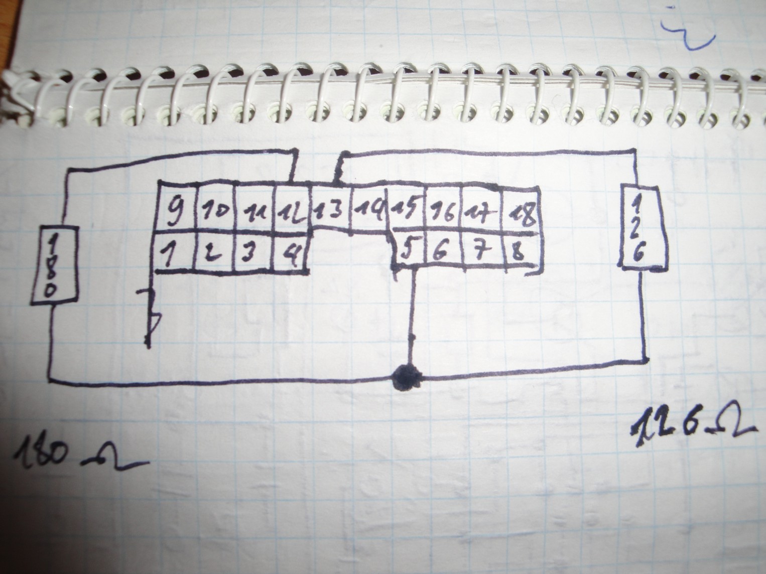

choyr Wrote:so it's pin 5, pin 12 and pin 13, just put 2 resistors for the Fuel gauge? is that 126 and 180 ohms?
To Choyr: This is how it must to involve.
