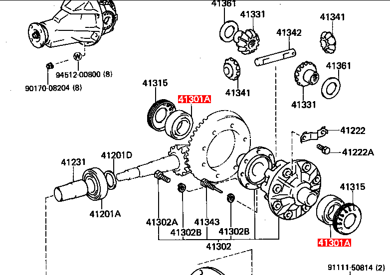

Hi Guys,
Does anyone have part numbers for these... not toyota part numbers, but other brands. I need the bearings marked in red on the pic... In ZaX's project post, there are some bearing numbers, but he wrote they are for the axles, but to me they look to skinny to be for the axles, so maybe they are the ones I am looking for, but not sure. Thanks. ![]() Always remember: Rev it till it blows, then back off a bit... Zenkis - Orange, Red/Black, Silver/Black, Maroon/Blue Koukis - Red, Silver/Gray, |

Bearing - LM501349
Bearing CAP - LM501310 you need one bearing and one bearing cap to make a complete bearing like "41301A" in the picture. I used the old one (without the rollers) and a hammer to put the new one in, make sure it goes all the way down |
