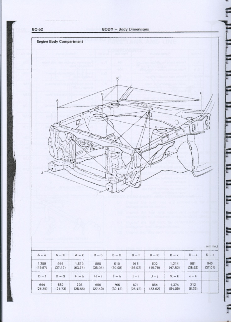

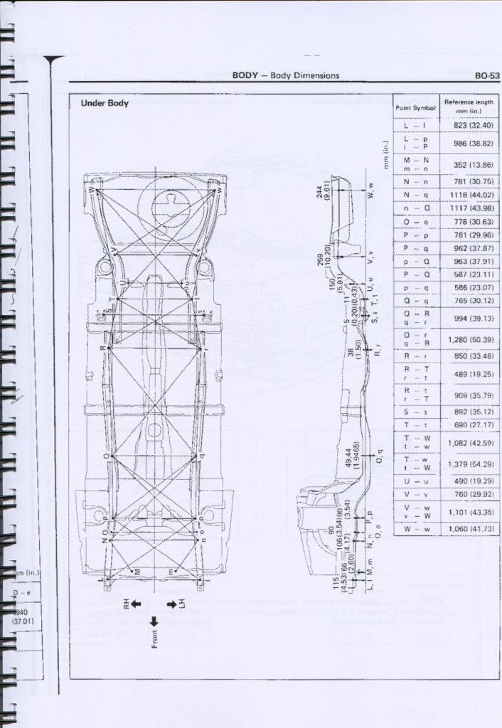

Anyone can help me find the detailed AE86 body dimensions?
We need it to restore an old racing car to ... a "new" gravel racing car, and we must do all the original state bodywork to register the car as an "historic racing car" for historic rally events (in a few years).
Imagine that you have a crashed car and you need to straighten it.

Should the need ever arise for more detailed bodywork info I have the body repair manual..it has about every measurement possible in it.
02-22-2006, 10:10 AM
Detailed Body Dimensions
Ivan141 Wrote:Should the need ever arise for more detailed bodywork info I have the body repair manual..it has about every measurement possible in it.
Can I have it please? That's what we really need!

It'll take a while before I can get to it...this weekend maybe.
02-22-2006, 05:41 PM
Ivan141
Any chance that you could put it on this page for download?? the body repair manual that is! Thumbs up!

That would be something nice to add to the workshop manual section Thumbs up!
02-22-2006, 10:51 PM
I think these would help!!! :wink:
