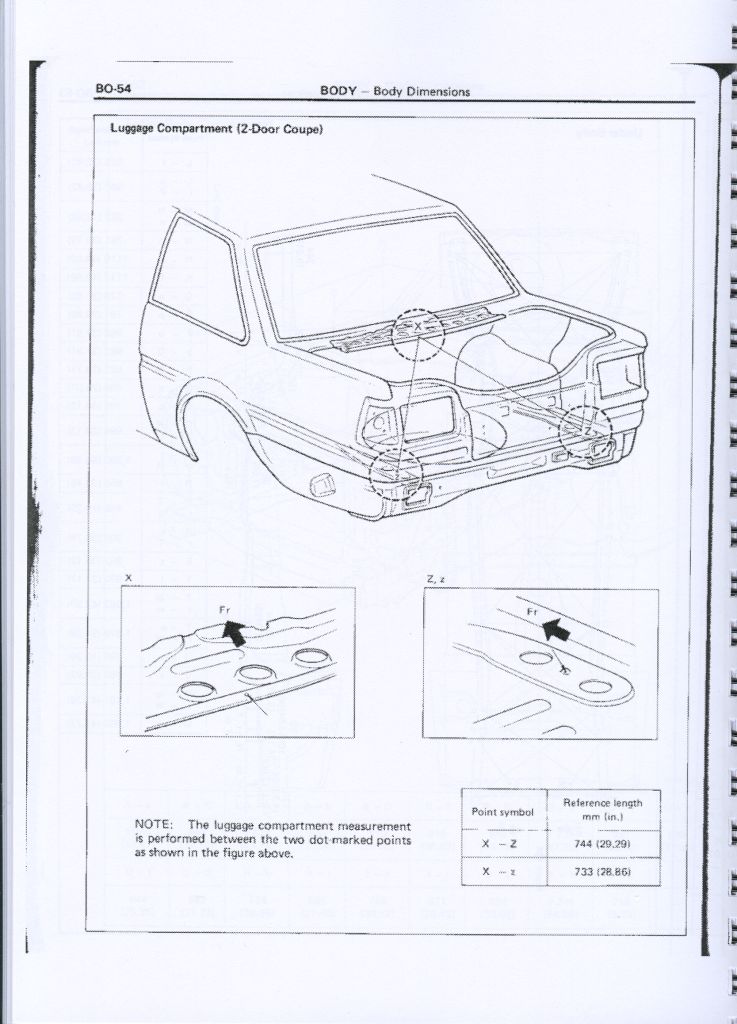

Anyone can help me find the detailed AE86 body dimensions?
We need it to restore an old racing car to ... a "new" gravel racing car, and we must do all the original state bodywork to register the car as an "historic racing car" for historic rally events (in a few years).
Imagine that you have a crashed car and you need to straighten it.

Cool check hte manual!

I checked the manual, but i stopped at "Safety Pad" section, as the body figures ended there. It was few pages after that... Sorry...

Should the need ever arise for more detailed bodywork info I have the body repair manual..it has about every measurement possible in it.

Can I have it please? That's what we really need!
