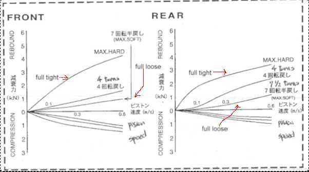

There are some graphs available for the tokico HTS..search around on the interwebs, don't have them handy. They looked pretty good. Would be interested to see the TRD ones.

I copied these of the internet somewhere a while back. Its the Tocico HTS ones mentioned.
[img name=]http://www.aeu86.org/files/ht/htsadjustmentscale_208.jpg[/img]
[img name=]http://www.aeu86.org/files/ht/hts_graph_main_large_163.jpg[/img]

Thanks guys for your info.
I'm a suspension engineer and bit of a geek so I've made my own spreadsheets. I've been calculating Roll centre height, load transfer etc. I haven't done any SDoF models though.
With regards to damping forces I'm hoping to calculate %critical damping so I can estimate what springs I can run with my Greddy's - I'm hoping to run softer springs.
I did the same thing with my S15 to spec my own springs rates and I was very happy with the result.
I'll try to get the Tokico HTS info off the graphs and see where they come out.
