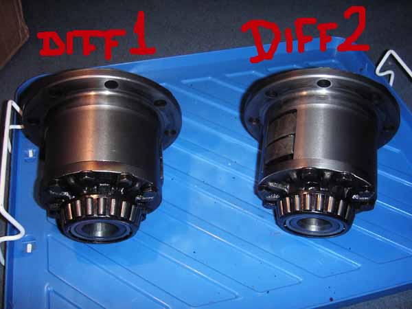

Ok, thats how the story goes:
I got 2 diffs here. One is in good condition, the other looks crapy.
I need some help recognising WHAT ARE THE DIFFERENCES between the two diffs.
I post pics with the differences I spotted.
DIFF 1 = crappy one
DIFF 2= good one
[Image: AEU86 AE86 - DIFF Comparison, I need HELP!! 56k warn] http://www.jdmbits.com

About those dents:
One is just the bearing....can easily be fixed...press on a new bearing.
The dents on the other side are not fixable...but they shouldnt necessarily be a problem. They do make it more prone to stress damage. I've seen those teeth marks on the side on a few diffs.. theyre also not a problem as far as I know.. Why dont you open them up? I think the nr.1 diff might have some more damage inside, since something must have caused those scratches and dents on the outside.
