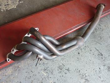

ok so i shelled out the money for the extractors and got them on and i'm pretty sure the car is slower than with the standard manifold!!!
I originally had the standard one with an A'pexi 2 1/4" resonator and a 2" stainless system with a Kakimoto muffler. The new extractors are stainless 4-1 with about 42mm primary piping down to a 2 1/4" flange. There is a small leak in the collector where it has been rewelded poorly previously but this is only like a pinhole gap where i can feel gas coming out. Has anyone got any ideas why it feels alot slower? It doesn't pull at all through the rev range, even at above 6000rpm. Has anyone got any explanation or experience with this? Even a more certain way of telling if it's going better or worse besides getting it dyno'd before and after. ![]() Thanks heaps. |

Very simple. Feeling of speed comes from torque. Torque comes from 4-2-1 headers. High rev hp comes from 4-1.
If your engine is standard it will feel slower. If you have a midly tuned one its better in the high revs. If you have a high rpm one with high hp then its noticable between 4-2-1 and 4-1 Cars: "99 Lexus IS200 "86 AE86 Kouki Panda Levin GT-Apex (restore project) "84 AE86 Zenki Blue Levin (project racer) Motorcycles: "02 Yamaha R1 "02 Honda Hornet S "08 BMW R1200GS |

True. So on a mildly tuned engine, it should accelerate faster at high revs?

As has already been mentioned, 4/2/1 headers improve the midrange, 4/1 headers improve the top end. PROPER sizing is VASTLY important, too large and you will lose power!
If I may ask...... can you get some of the dimensions? Diameter of primary tubing. Diameter of secondary tubing (below the Powerball). Also the length of the primaries from the flange to the Powerball (measure the outside radius for accuracy) Dan - You can | OST Porting service - http://hachiroku.net/forums/showthread.php?t=19991 |

Yeah that's right, have the primaries and secondary pipe size in the previous post. Would recommend these, moves the powerband higher in the rev range and feels great, suits the style of driving that it is used for, works especially well with the 4.8:1 diff ratio.
