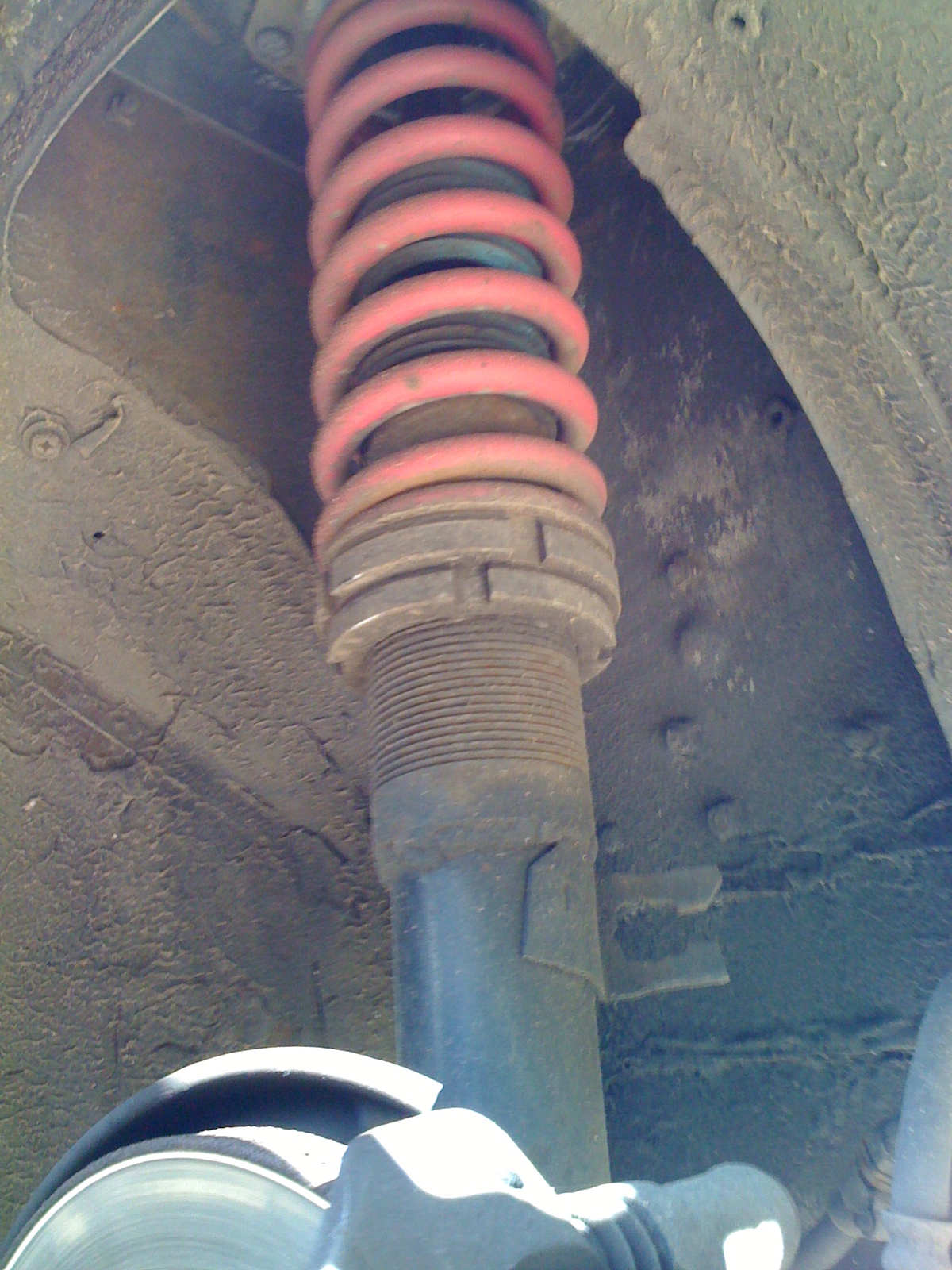

I got 1 pic of my coilover that has collapsed its not the best pic and i'm not sure if it will be any help identifying them
05-13-2012, 07:10 PM
Coilover help
Original strut, welded coilover kit over it.
hard to tell the brand for that kind of product Undecided
Anyway, you should be able to use AVO (MCN) shock on it since they are made for stock strut Smile
