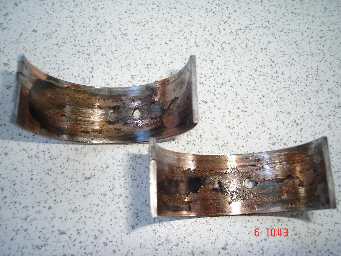

Heres the bearings from cylinder 1. No damage to the crank, only some of the soft material from the bearing is "burned" onto the crank. It could easily be removed with a razorblade...

I would advise against using a razorblade...use some solvent and a soft brush..As long as there are no scratches on the crank you can put in new bearings..
