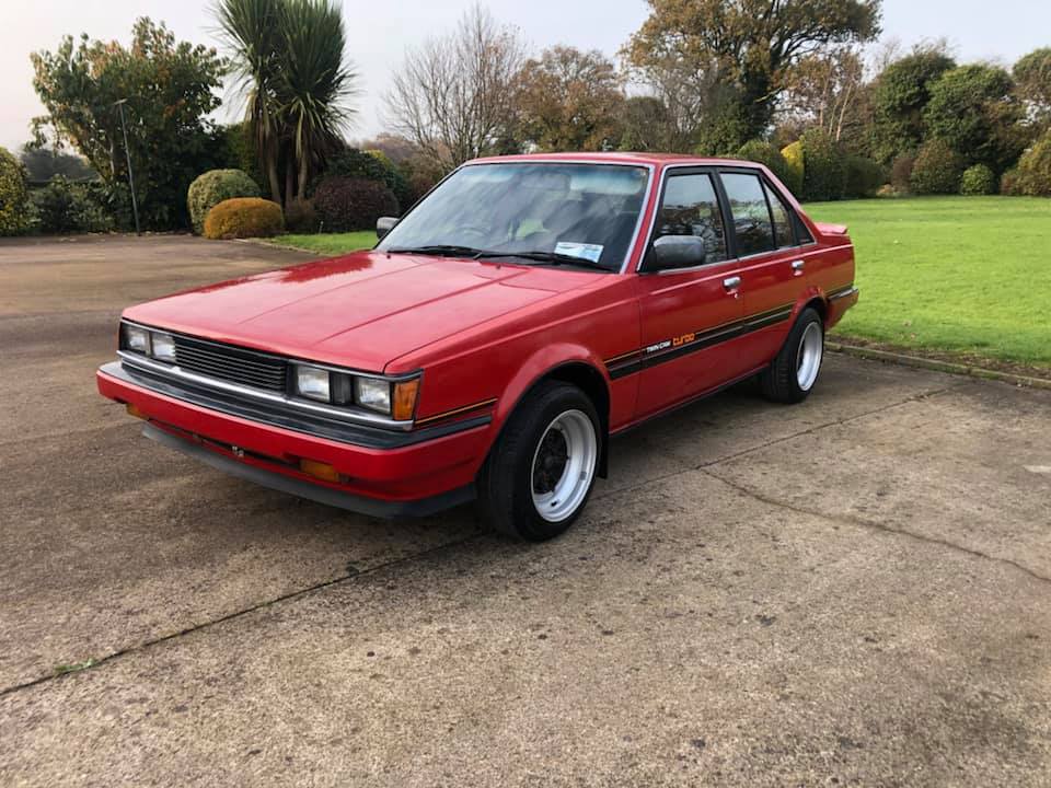

And of course we would like to see pictures of your TA63! Thumbs up!
[Image: AEU86 AE86 - Carina TA63 GT-TR - Suspension??]

(01-18-2021 09:50 PM)banpei Wrote:  And of course we would like to see pictures of your TA63! Thumbs up!
