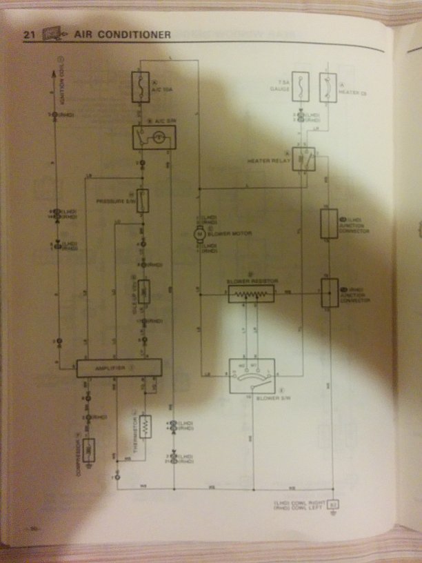

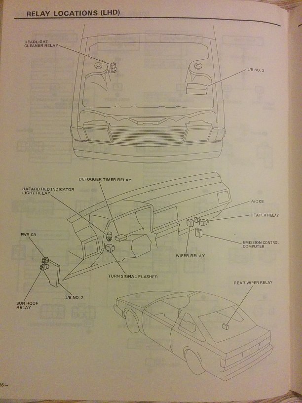

I made a few photos of the relay positions and wireloom.
The blower relay is apparently on the passenger side:
[Image: AEU86 AE86 - Carina TA62 / TA60 heater b...ed working]
If you look at the wireloom the power is also cut by the gauge fuse:
This fuse can be found here:
However I would expect the gauge cluster to be non-functional too if the fuse breaks. So I would say that due to the water either the relay or the heater unit itself broke.
