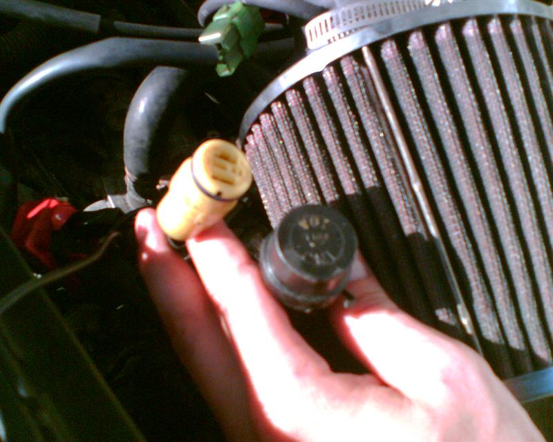

Did anybody ever checked ground on ECU (E, E1, E2, E01, E02), directly on pins of ECU compared with the body ground (plain ground of chasis of the car) ?? Results??
Did anybody have encouter blown Check engine light (the bulb) on the dashboard ?
My AE82 4AGE has wierd fuse just on 2 wires, deattached from everything else in engine compartment, and if disconnected everything looks OK, but engine wont start. It's located on the gearbox side, near the water sensor of the cold start injector.
Does AE86 4AGE have the same wierd fuse ??? (we looked but didn't find it, only 2 the same connector, but nothing was on them)

Meshin, I don't know what you've got but since there is an aftermarket air filter on it, I'm guessing the PO disconnected something and the fuse you are looking at is a "PO Special". Only the Gods know why it is there or what he connected those wires to. One thing you can be sure of, no car manufacturer will ever leave a fuse "hanging in space" that way. Every electrical code and standard on this planet calls for fuses to be secured to something, even if that means just a clip holding them to the trim. Maybe the PO put it in as an antitheft kill switch.

Red Wrote:Meshin, I don't know what you've got but since there is an aftermarket air filter on it, I'm guessing the PO disconnected something and the fuse you are looking at is a "PO Special". Only the Gods know why it is there or what he connected those wires to. One thing you can be sure of, no car manufacturer will ever leave a fuse "hanging in space" that way. Every electrical code and standard on this planet calls for fuses to be secured to something, even if that means just a clip holding them to the trim. Maybe the PO put it in as an antitheft kill switch.
That's why I'm asking... is it only "option" in my car or AE86 has something similiar.

"That's why I'm asking... is it only "option" in my car or AE86 has something similiar. "
The AE86 has no fuses hanging on wires like that, and no fuses up by the air intake. There's a connection to the airflow sensor in the intake can, and other wiring, but offhand...I have no idea how that relates to an AE82.
