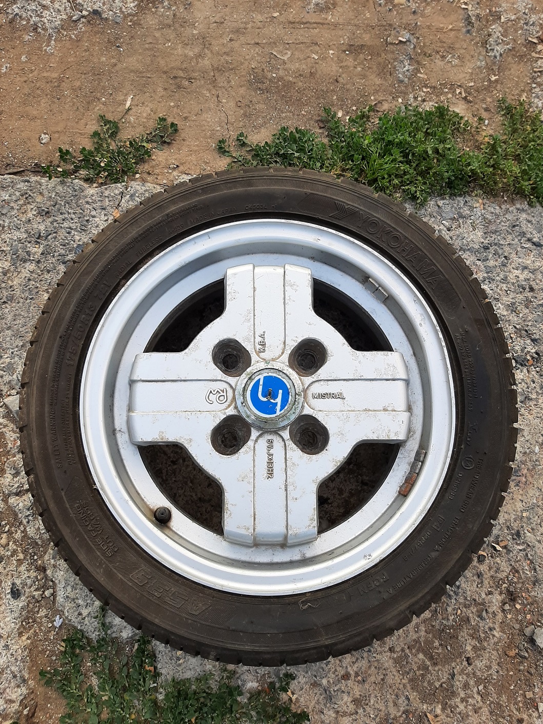

Hello i have been looking for some rather conservative design wheels Smile for my AE86 and found these but i am not sure if the offset will be the same as for the 14 inch steel wheels. Size: 4x114,3 R14, ET35, they came from Nissan Silvia S12. Can anyone tell me if they will fit on the inner side? Compared to my Allycat wheels they will go 10mm to inner side. Not sure how much clearence i got left but i will measure it again.
Anyway i was looking for the name of the wheels as well as i recall the design but this was quite a while back so i can't remember.
Thanks for any advice.

what is the width?

width is 5.5 sorry forget to mention it

it will fit

If not you can run 10mm spacers to geht them away from the strut

Assuming you know this already, due to the high ET and low width they will look a bit lost (very tucked in) underneath the arches. At a guess they will sit somwhere around 45mm inwards from the outer lip (or about 20mm further in than stock)

porsche 356 look TongueTongue tucked in wheels Big Grin

(12-02-2016 05:05 PM)DJexor Wrote:  porsche 356 look TongueTongue tucked in wheels Big Grin
probably one of the very few cars that can actually pull that look off in a good way

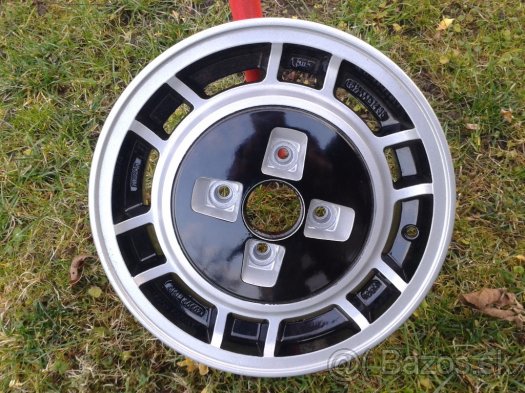

Hello. Didn't want start new topic and spam the board. I have question about another set of wheels i came across. Can someone help me to identify the maker of these as i have really not clue and googling didn't really help. They where on suzuki swift gti mk1 from 87 they are high ET so probaby on hachi useless but planning them to use on swift. Thank you Smile
Another photo
Another photo
