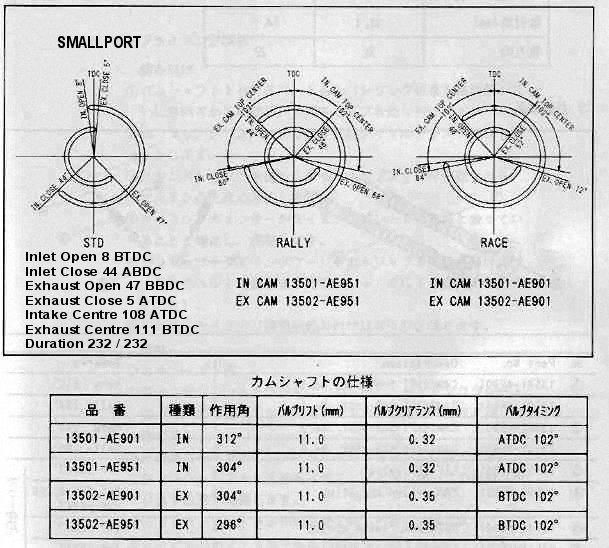

05-23-2009, 06:25 PM
Cam timing help
Far left is std.
[Image: AEU86 AE86 - Cam timing help]
Dan -
05-24-2009, 12:59 AM
Cam timing help
Good stuff Oldeskewl Smile
I had a bit of a struggle to read the numbers, so I have reposted
your info with my best guess figures shown below the std cam. Feel
free to correct anything I have figured wrong.
And since the numbers give 232 duration, they are the smallport
numbers I was looking for. Now I have some work to do Smile
Cheers... jondee86
[img name=]http://www.aeu86.org/files/bi/biblecaminfo01_179.jpg[/img]
