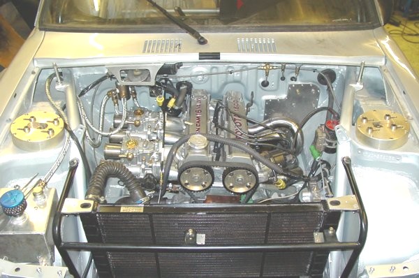

WKD RWD Wrote:This is my 4AGE running twin 40's and powered by a Ford Sierra distributer (must be from a 1300 or 1600cc pinto engine sierra) and Ignition pack
yeah,i wanna know how you did that dizzy Big Grin
i run webers on the stock ecu(and that sucks,you cant get the timing right)

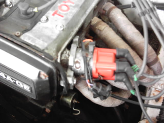

i wish i knew myself, Mike Nelligan, Knocknagoshel, Co. Kerry, Ireland, made it up, i watched him doing it,
he needs a 4AGE Distributer and a Ford Sierra Distributer from a 1600cc Pinto engine, he then machined it so it has a Toyota shaft and splines but a Ford base, and uses Ford Rotor arm and Dizzy cap, its very smart though it doesnt look that clear in the picture
You also need the Ford Motorcraft ignition pack that plugs into the Distributer. So find an old Sierra somewhere, send dizzy and a Toyota one over to him, address up above, and youre set, I'll pm you his number if you want to talk to him first, try to get better pics tomorrow also Wave
