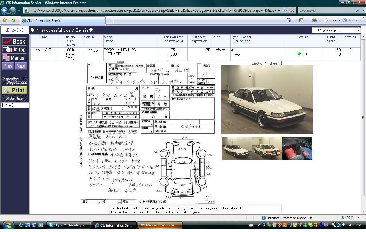

I have bought this two door coupe from japan and its still there but th auction grade is grade 2 and there is rust on the left rear fender back arch and on the boot.
Can any one understand the auction sheet and help me understand what the car has and hasnt got ?
How bad is the rust should i toss the car for spares?

There are very few people who can read Japanese on the forum.
Why the anxiety? You obviously knew there was a risk when ordering the car, just take it easy and see what you get when it arrives. Knowing how bad things are wont change a thing, unless you have the money to go and order another one so you wont have to wait too long.
Generally, jap AE86's are not complete rustbuckets.

Quote:Grading:
The auctions on our website are a combination and translation of a number of japanese auction house auctions. Their gradings are not exactly the same, but the summary below is fairly accurate.
Good Grade vehicles:
Grade Means Comments Remarks
5, 6 or above As new condition Usually current year model, very low k/s and no blemishes or marks, showroom condition
Pay the money but get a near new car
4.5 Excellent condition Showroom condition slightly higher k/s
4 Good condition for age & k/s Good condition for age & k/s may require some minor paint touch ups. Best target !!! Value for money
3.5 Average condition to below average for age & k/s Will require some reconditioning &/or paint touch up work, usually cheap for age & k/s Ok if you don't mind scratches etc
Note 1:
After the number sometimes you will see two letters, the first letter relates to the exterior condition and the second letter relates to interior condition. Any repair required is not due to a road accident, but general wear and tear:
A - No need for repair. (Excellent nice condition)
B - May require cosmetic repair or cleaning. (Reasonably nice condition)
C - Needs repair. (Some work required)
D - Obvious it requires repair. (Needs attention, poor condition)
Lower Grade Vehicles:
Grade
3 Some small previous accident repair or poor condition Small repair or poor condition but often if small repair can still be in tidy condition for age & k/s and often cheap Sometimes ok sometimes needs a lot of work
2 Very bad condition Would not recommend a grade 2 Are you that keen?
1 Modified car or some other situation Will only consider if client requests a modified car.
0.1, R1, RA1 Modified & repaired Will only consider if client requests a modified car.
0, R, RA Accident repaired vehicle or Small or very good repair hard to see Sometimes ok
Larger accident repaired vehicle or bad flood damaged.
*** Damaged unrepaired or suitable for parts only
Other Letters:
Grade Means
S (better than grade 7) Perfect new car condition
T Special purpose vehicle
Note 2
Auction Houses differ and there are some variations to the above grades but generally these will give you an idea.
Quote:A:Scratch
U:Dent
B:Dent with other defects,deep scratch
W:Repaired trace
S:Rust
C:Corrosion
P:Paint required
X:Replacement required
G:Windowscreen Stone chip and /or scratch
hope that helps

Would it be possible to interpret what is written on the auction sheet
I know the car has a lsd diff.
but thats about it.
Should i be worried about that level of rust or should i still import the car and be prepared to do some sheet metal work and rebuild the different sections of the body work??

Its very rare to find an ae86 without rust, just don't be scared of rust. treat it and drive it. Wink
I can also imagine that the level of rustyness in japan is a good step lower that for example in salty europe.

I would import and fix it but that's me so do what ever you think is best - I can't read japanese so do know what's written there but as mentioned before every ae86 has some rust now and then so no surprise realy... regarding the spec shhet it category C and not D so I guess mild repairs...
go get it especially if you have the money to get another one get this fix it and spend some time on the track with the leftover money Wink
this is just my 2p and how I'd go about it...
