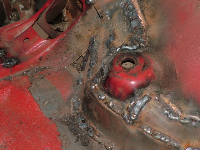

What do you think?
Those 5mm plates around rear struts should be strong enough Thumbs up!
Fun is not the straight line!
11-29-2005, 12:29 PM
Bodywork in 3 steps
max_ae86 Wrote:What do you think?
overkill
steel will broke up in the weakest place anyway.
continue work in that way and u will loose weight balance also Smile

Well, I’m not as fast as Zax, regarding car rebuild but…
…no more rusty holes at the back! I hope 0,5 kg more at the back will make no difference. In stead of 3mm I put 5mm plates. It’s only 2mm thicker plate.

hMM,
In the rear tower ,there is two plates .
There is regular 1mm plate,and a 2mm!
So it i think that what you have made here is weaker then OE

Denmark Wrote:hMM,
Regards,
Skassa
But surely, better then a rusty hole, which I had before :wink:
