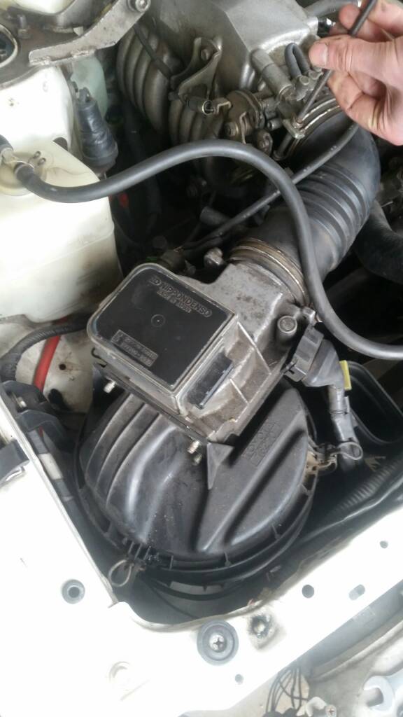

Hi all,
A friend of mine has a bluetop 4AGE.
It has an AFM and he would like to remove the air box and use an aftermarket air filter.
How can he do that ?
We remove the AFM but we have no solution of how to fit another air filter. Impossible to use an adapter.
We need help. Thanks

Injen or Apexi
[Image: AEU86 AE86 - Bluetop AFM with air filter]
But to be fair, he will not gain anything from it. (appart from running a lot richer)

The inlet of the AFM is not in circle.
It's square.
How can I find an adapter ?

the Injen and Apexi units are kits that include the filter

(04-28-2016 07:49 PM)izanagi Wrote:  The inlet of the AFM is not in circle.
It's square.
Can't speak to the others mentioned so far... but the K&N FIPK for the AE86 has a tapered square inlet
