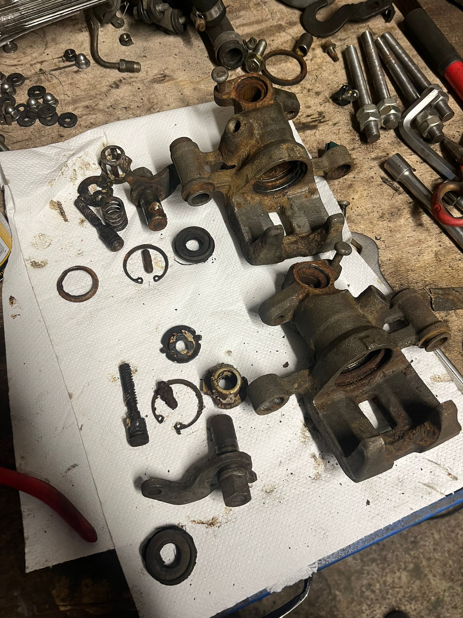

So first of all i've managed to rebuild completely all of my brake calipers. I've purchased the complete rebuild set from a spanish site (https://www.frenkit.es/en) very competitive price, around 20-25€ for each caliper with the pistons included.
For the brake caliper i did a very basic treatment. Soaked everything in vinegar for a couple of days, cleaned everything with a wire wheel and used as base cold galvanizing spray and as top coat used an high temperature spray, not needed really for the temperature but more because once dry holds better. Overall a very cheap restore i would say, but i'm pleased Smile

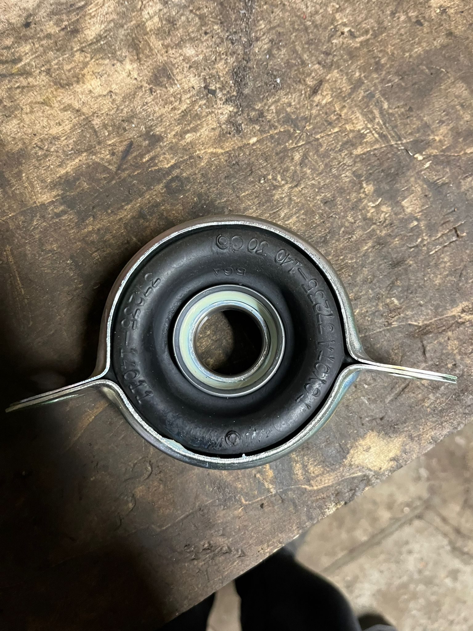

I have changed the prop shaft center bearing since, as you can see the old one was in very bad shape. So the prop shaft is now ready!
[Image: AEU86 AE86 - RE: Blaze's AE86]

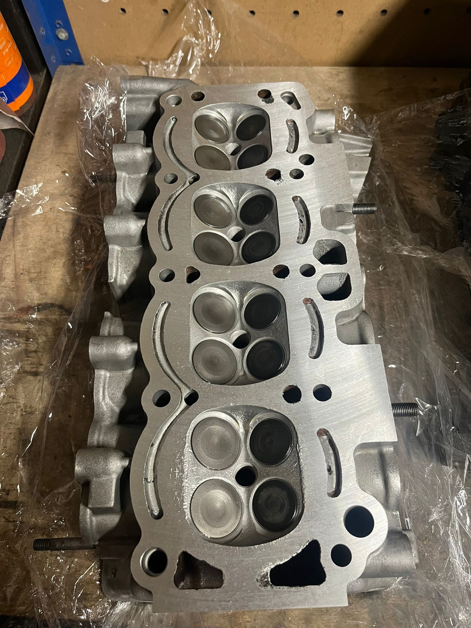

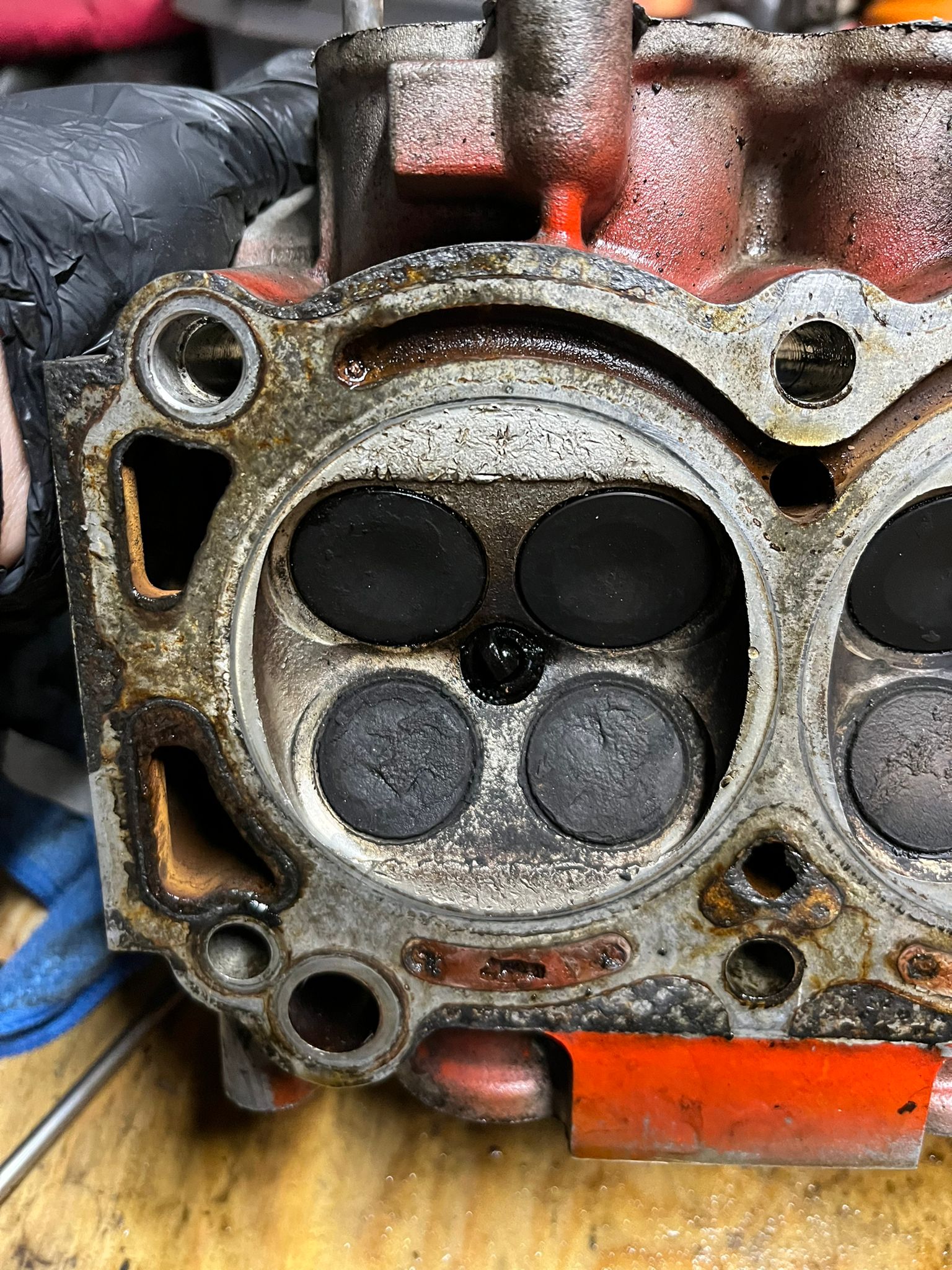

Skipping to the engine, the first head i've sent to the machine shop was unfortunately cracked in 3 different place, no chance of fixing it. So i've bought from our good FanIsHere a big port head. This head on one of the combustion chamber had some denting, probably some metal pieces that bounced in there for a bit. Luckily after resurfacing the head it seems a lot better, and i might just go and with a fine file and try to smooth as much as possible the remain imperfection.
Skipping on the enginge, the first head i've sent to the machine shop, was cracked in 3 spots, with no chance of fix. So i've purchase from our good FanIsHere a big port engine, where in 1 of the combustion chamber there was some denting probably caused by some metal piece bouncing in there. After the resurface it looks much better and i might try with i fine file to just smooth the remaining imperfection as much as possible.
