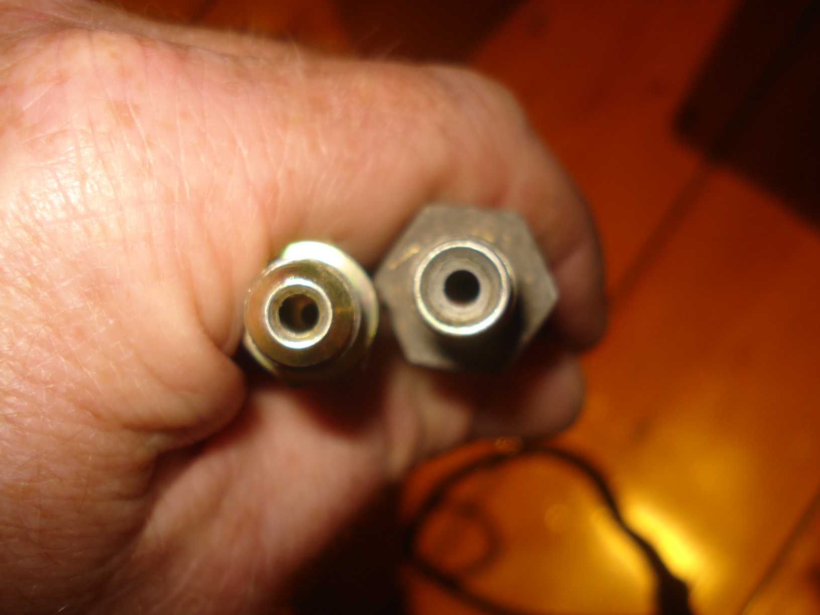

Lovely looking lines, however the fitting at the caliper end does not seal. I am using standard 2022 calipers on the front and standard rear calipers.
[img name=]http://www.aeu86.org/files/ds/dsc01031_265.jpg[/img]
As you can see, the chamfer is wrong (convex). There is a very small concave chamfer with a 1 mm wall thickness around the lumen.
Spoke to Tony at Fensport whose answer was that they will fit as they are chamfered both ways. Well I have and they don't. They seep with only gravity. The old line is what the fitting looks like on a factory line
Black Diamond haven't responded as yet to my email and I am contacting Tony again.
I can only assume they have put the wrong fitting on the end of the line.
Has anyone else had experience with these lines on an AE86

Update: Tony has kindly arranged for a set with the correct fittings to be made up and sent to me. I have posted the ones I had back to an engineer in the UK per Fensport for assessment.

then i hear that "Your lines are now back, they have been tested up to 1000 psi and there is no problem with them.
They have also checked the ends and there is no problem with these."
Whether the lines could cope with 1000psi was never the issue, the fitting into the caliper was, and I still fail to see how these could seal, which they didn't.

For anyone out there looking for braided lines, I can tell you that the Goodridge lines have the correct fittings, same as Toyota.
Buy Goodridge, NOT Black Diamond, which have the wrong fittings.

Yes, I am convinced they have put the wrong ends at the caliper end, and they don't seem to be capable of understanding the problem.
The pictures are quite clear on that front.
