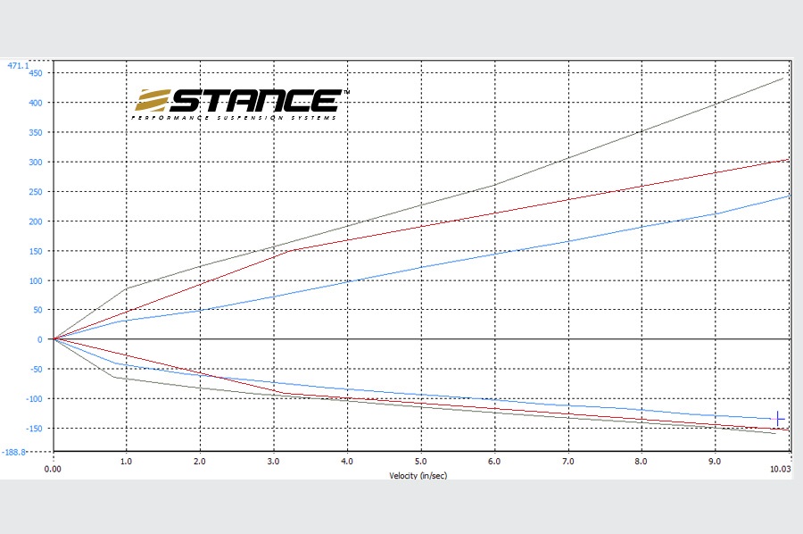

finally one of my research seems to have come to an end - unless I receive a very good offer in the next few weeks from KW - I will go with *drumroll*
Stance - they offer me a custom set of coilovers for ~2150euros, including spindles which are height adjustable and to make this any different from other options they are 3-Ways. Meaning instead of the very common combined adjustability for rebound and compression; these offer 15 levels off rebound, 15 levels of low speed compression and 4 levels of high speed compression adjustment.
this looks something like this:
[Image: AEU86 AE86 - Bean Bandits Levin 'Globetrotter']
and here a graph of a single/combined adjustable damper they had on file for similar spring rates I asked for (6/4.5kg). I did an overlay of NoHachi's study - the 3-ways will allow for a bigger and more precise range of adjustment. Blue= full soft, black = full stiff, red = NoHachi's approximation.
