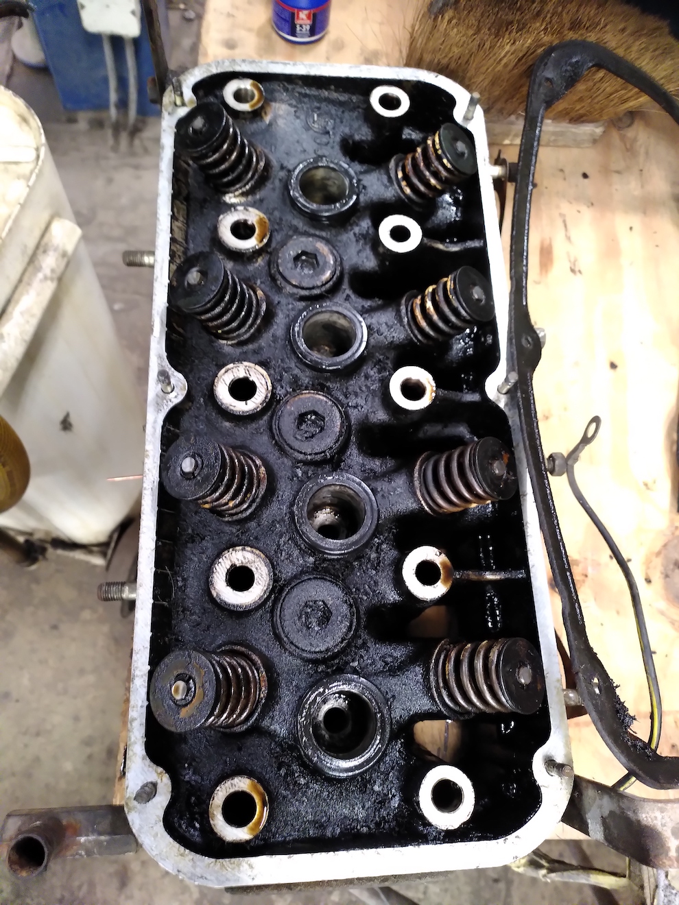

Fast forward three weeks and we're down to this:
A new engine. Banging head
The block turned out to be warped at cylinder #3, so I had to source a replacement. The photo above shows the engine after cleaning as it was very dirty.
How dirty you may ask:
This dirty! It's as if someone forgot to drain the engine oil and topping up the engine for the past 10 years! Banging head
It had some lower compression on cylinders #2 and #3, but most probably it was due to the deposits on the exhaust valves and close properly due to this...
Luckily after cleaning the engine it turned out to be in excellent condition and no scoring on the cylinder walls. Hurray!

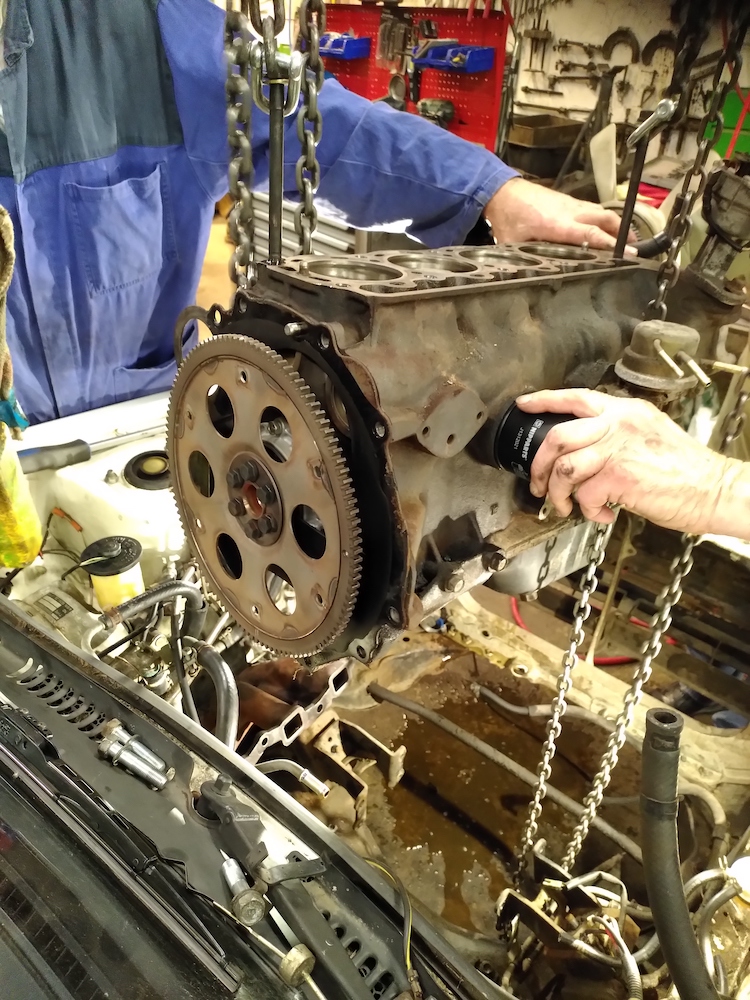

So I dropped by and found the people in the garage doing this:
Yep, they just lifted the engine out of the car when I arrived.

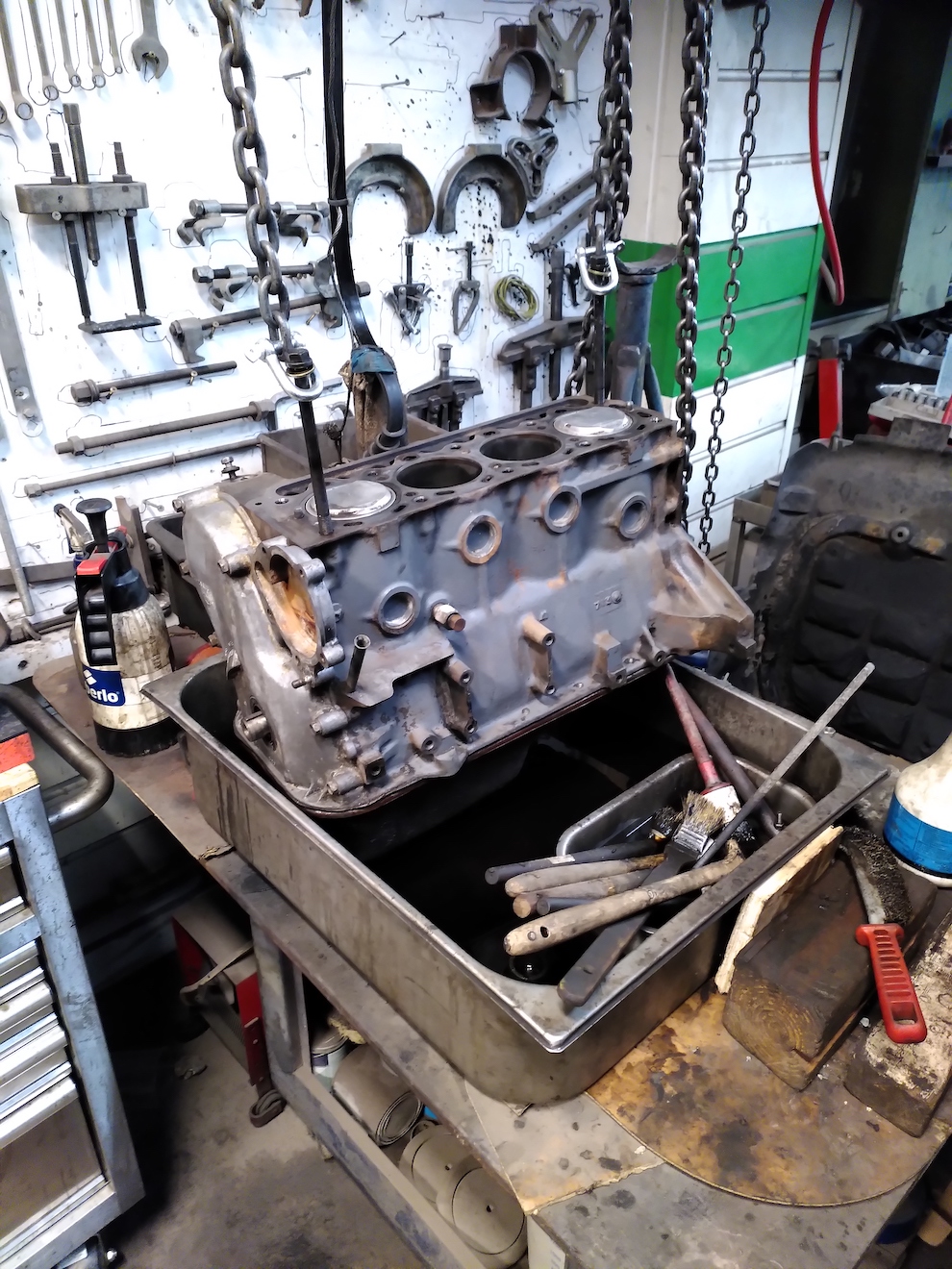

I also found this on the bench:
The head came out very well after cleaning, valves were cut and compression test was good! Thumbs up!
Finally, the bottom also was cleaned up well and ready to be mated to the head again.

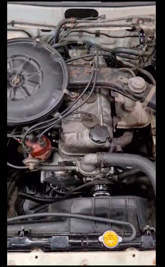

While being on vacation my mechanic rebuilt the engine and installed it:
This is actually a screenshot of the video he sent me on Wednesday, but forgive me for being lazy and only posting the screenshot. Wink
He said at the end of the video he would test drive the car. On Thursday he called me while I was passing lorries in the left lane on the autobahn, so of course I didn't pick up my phone. Banging head
When I called him back he had bad news for me: during the test drive the engine suffered from fuel starvation so I'll also need a new (mechanical) fuel pump. I found out there are actually two types of fuel pumps for the 2T engine: with two and three connections. The former has an inlet from the fuel filter and outlet towards the carburetor. The latter has an additional outlet for a return line. Both seem to have the same partnumber (23100-19105) and diagrams show both types. Banging head
