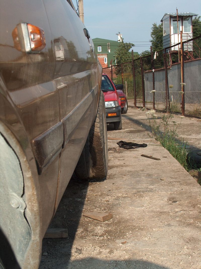

Toyota-Nissan hybrid
(sorry for the poor quality of the photos) AE86 GTS '84 Red Top |

Whoa cool! I order you to put better pictures online and at the very least a better description of the process!
