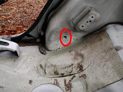

That brings up a question: anyone got a picture of how the 3 point seatbelts in the rear are mounted? I mean both in the trunk and also inside the car. Tongue

One of the seatbelt mounting points on my car is shown on the picture, it bolts into a nut that is welded on the inside of the rear inside wheel arch.
The tensioners can be fitted somewhere behind the plastic covering on the slope of the rear hatch. The things you click the seat belt into are fitted on bolts welded on the bottom of you car somewhere in the middle of the rear seat.
Just take some of the plastic moulding out where it is obvious the mounts should be and you'll find them.
