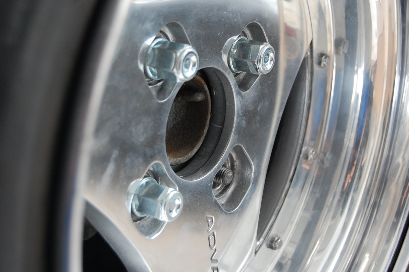

its a mag lug nut. much like the ones you need to mount celica/supra wheels to your ae86
[Image: AEU86 AE86 - Advan A3A need quick help]
many toyotas came with these lug nuts standard. i have used some from supras, chasers, celicas, carina, corona...etc
ones i like best are MA70 lug nuts as the top is open so you can use long studs on it.

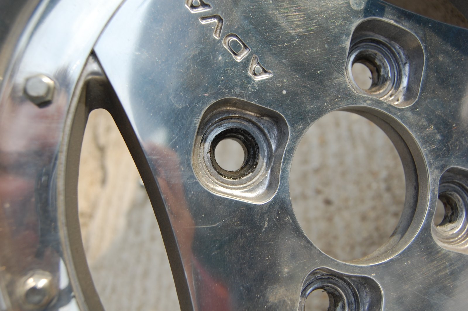

Thanks AEsuperG good idea just the ones i was having in mind but i see there could be also the problem because now i sorted space with those between the wheel studs and the wheel but the top of the holes are not flat on the rims so i am not so sure if they will tighten enough if i just put the washer on. I am looking on net if i could find some that have the " \ / " design.

its supposed to be flat. may have been years of people using the wrong lug nuts and over tightening. to get that "\/" design, you may need to machine some metal. or just use the washers and they will probably bend to that shape anyway.

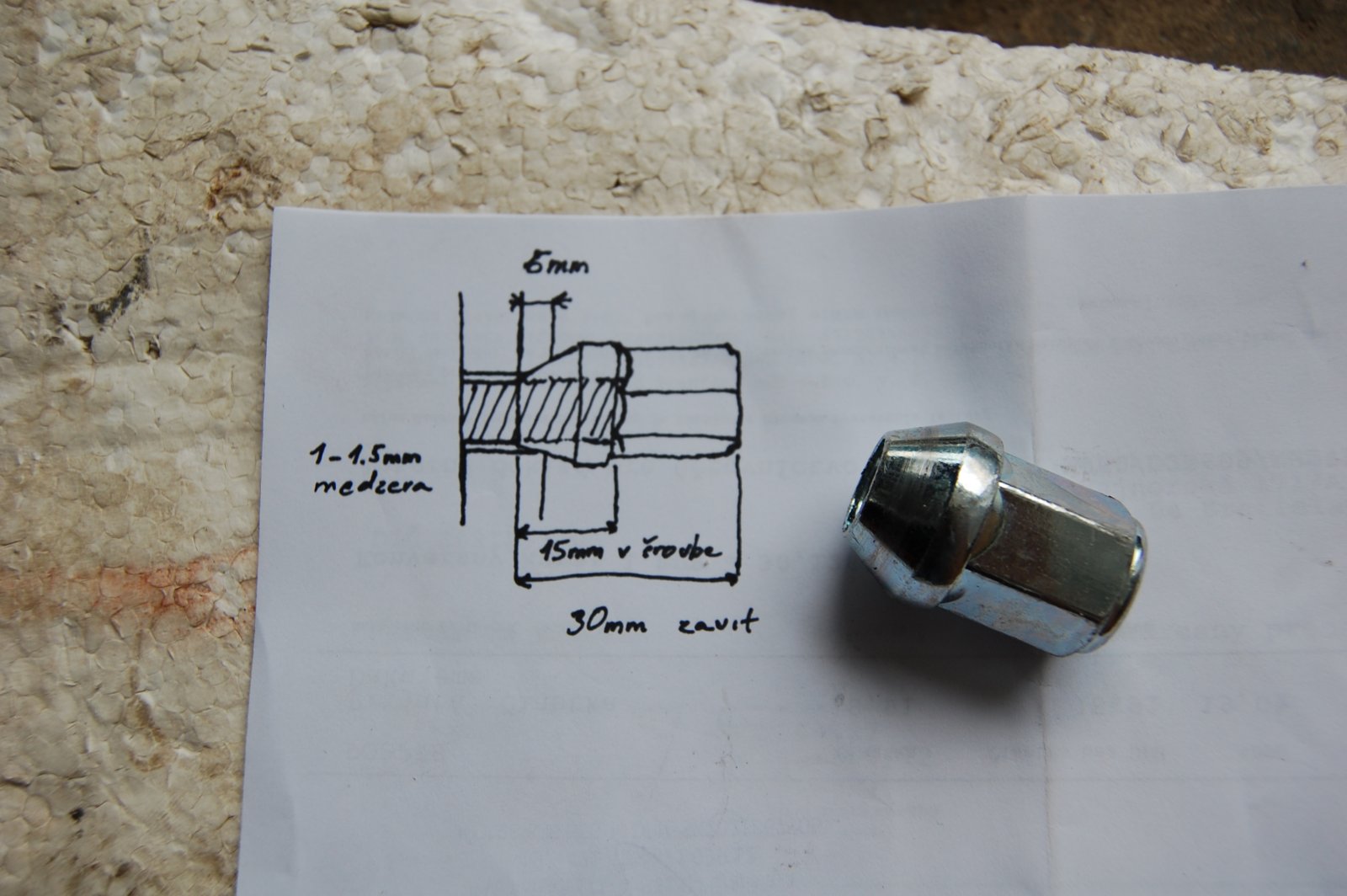

I got the lug nuts for my advans that fit i think pretty good i tried several different nuts but those steelies was the best so what i need to solve now is this question:
- the studs on hubs should have 22mm and they are having it also when i mounted the advans with the new lug nuts the studs go only to 50% of the lug nuts (you can see it on the hand made picture) A mechanic told me the studs must go to 75% of the lug nut so i am confused now should i replace the studs or not ?
- second question is must i use some sort of a spacer between the wheel hub and advan wheel because there is a big clearance. AE86 orignal hub is having about 60mm or 61mm diameter but advan wheel is having about 72.5mm.

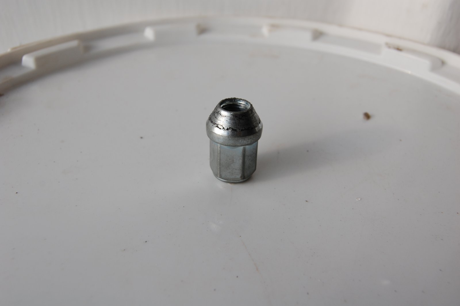

banpei i was visiting our local toyota dealer and ordered 2 pieces of the lug nuts for the ALU oem toyota wheels and they don't even go into the holes! i will provide pictures but they not fit. Apolan maybe the one's i just mentioned fit on your wheels i show on the picture after i get the photos tomorrow at the garage.

Ryo Wrote:banpei i was visiting our local toyota dealer and ordered 2 pieces of the lug nuts for the ALU oem toyota wheels and they don't even go into the holes! i will provide pictures but they not fit. Apolan maybe the one's i just mentioned fit on your wheels i show on the picture after i get the photos tomorrow at the garage.
Okay, I didn't know those holes were actually smaller! :o
I did some searching on and found that there are also Tuner lug nuts which do their mounting on the inside:
http://www.customwheelaccessories.com/TunerLugNuts.html
Perhaps that is also the case with these advans?
@Apolan: those CS lugs are the same as for the Intras
