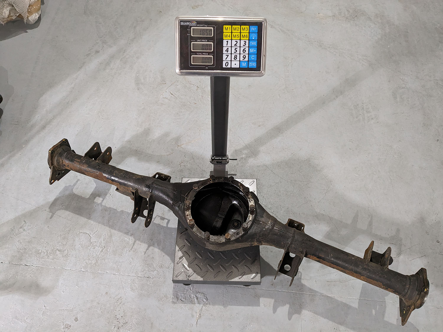

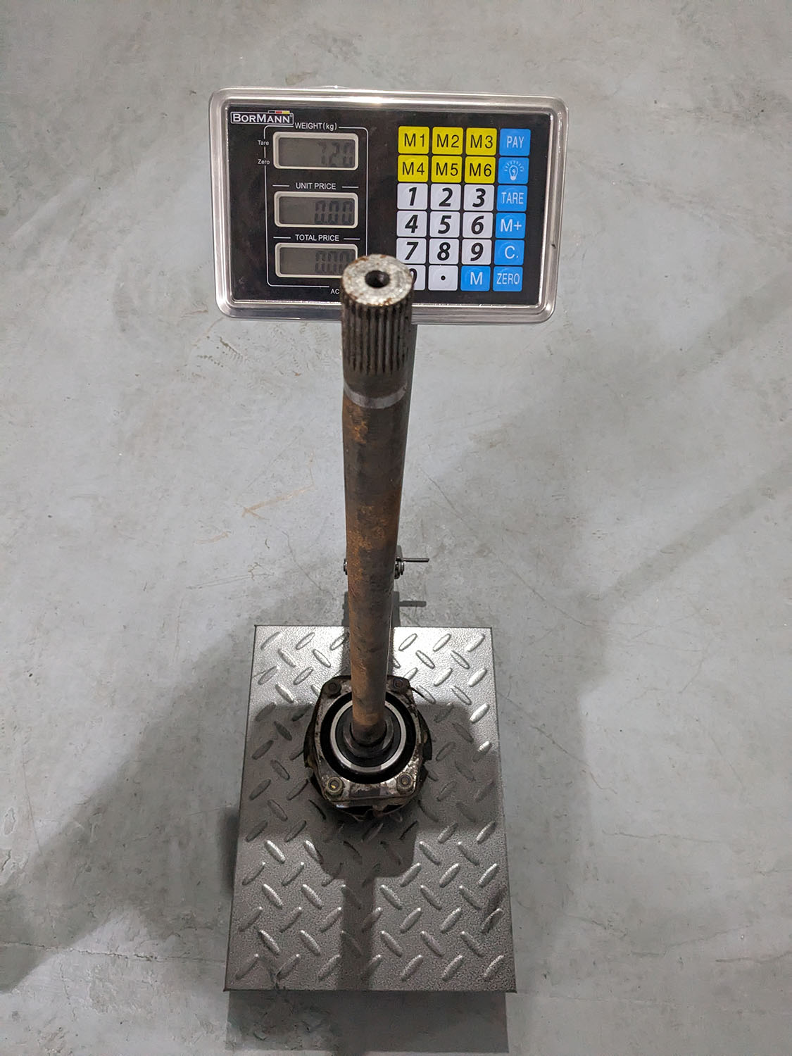

Reviving this thread as I'm about to install a Feroza rear axle on my 86.
Confirming that OEM late/kouki/thicker/25mm shafts/axles weight 11,3kg without bolts. Daihatsu Feroza/Rocky LSD rear axle detailed weighting 1. Each shaft/axle (converted PCD to 4x114,3): 7,20kg => 14,4kg for both 2. LSD differential, crown, pinion and pumpkin: 22,70kg 3. Axle/diff housing (no oil): 18,50kg So the Feroza/Rocky axle without brakes, panhard, swaybar etc weights 55,60kg in total vs the 86 axle which according to you weights 46kg. That's 10kg added weight. I will take the same measurements for the AE86 axle as soon as I remove and disassemble it. ![]() Follow: The story of my AE86 |
