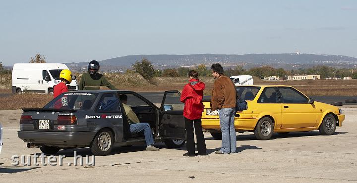

Here is a picture about my mate and me drifting last weekend.
[Image: AEU86 AE86 - AE86  Winter snow tips?]
Enjoy the winter! Smile
