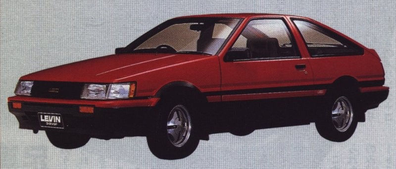

Hi all.
I'm new to this forum.
Keen on a car down here in NZ
Don't know much these wheels, but the seller is very nice dude and he says it's so original.
How many original types of the wheels there?
Also, What LSD does the Tureno GTV have?
Thank you
Andy.
01-17-2011, 10:28 PM
AE86, What does the Original Wheels look like?
It depends on the year, country and model range.
I think, apart from the steelies, there were at least 6 or 7 different wheels mounted on the hachi from stock.
To name a few:
- Pizzacutters (first design, like the one in your picture)
- Pizzacutters (second design, more square)
- Snowflakes (Black limited and USDM)
- Atiwe telephone rims (Benelux, Austria and Germany)
- Intra small spoke wheels (EU)
LSD was the same on all models: a 1.5 way LSD locking at about 45%. The LSD model differs between zenki and kouki cars because the axle halfshafts are different in diameter.
