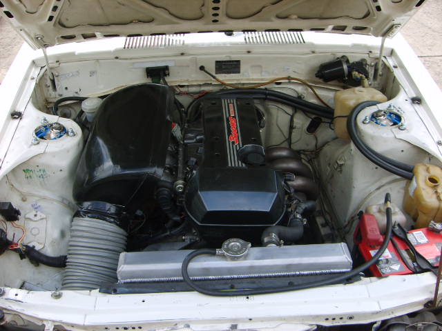

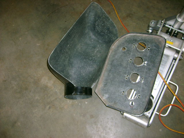

you do know that i make a harmonic balancer but it has only 1 ribe set up for the alternator ,i will take pics when i get around to it ..also make a 12 liter air box assembly so the 2 stage sits inside with a 6 inch hole for a whitches hat unifilter to sit in

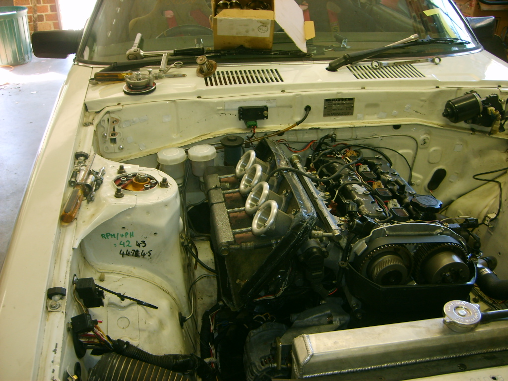

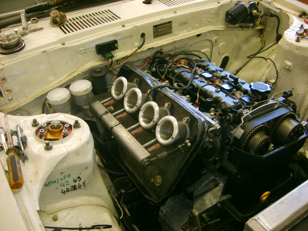

Glenn, cheers for the info Wink I'm going to run without the harmonic balancer for now and the stage two's are coming off in favour of some nice trumpets. The new airbox will be fabbed once the engine is in the car and I know how much room I have to play with between ITBs and the inner wing Smile

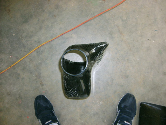

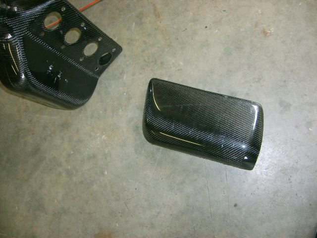

ok some pics of the race balancer and 2 air boxes as welland last pic with it on the car

WOW!!! Check the volume of that carbon airbox.... It's going to resonate with the induction pulses and sound mental! - looking forward to hearing this!!! Thumbs up! Thumbs up!

You may need to drop the front brackets that hold the tension rods and ARB as the ARB will foul the crossmember when the car is on the ground fully loaded.
Im doing the F20 swap at the moment and I ran into this problem and Im running the same crossmember spacers.

Glenn, pm me with details of the carbon airbox please, price and dimensions and some pics of the filter arangement if possible.

Cheers Maurice, I'm sure the guys will sort it when they sit it down.

Oops. Assumed it was already a feature. Open throttles sound fantastic too. Just a thought - does the airbox close and stay tightly closed? Have the ones been used prior rattle at all? Any sound clips?

ok the carbon air box is the small 1 and is 450 plus postage and the 1 on my car which is 12liters in capacity is 250 plus postage
