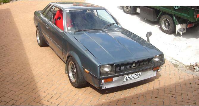

Hey guys,
Well this is my fist post of this site i have been looking for some sites for my new AE70 Sprinter but no one seems to have anything on them!!!
My question is really quite simple to anyone who knows this car and the 4age
Question as follows;
I need to know if a blue top 4age will fit into the engine bay using the original engine mounts
All so how much power dose a standard 3-AU engine have
Thanks so much for looking at my post
David.
