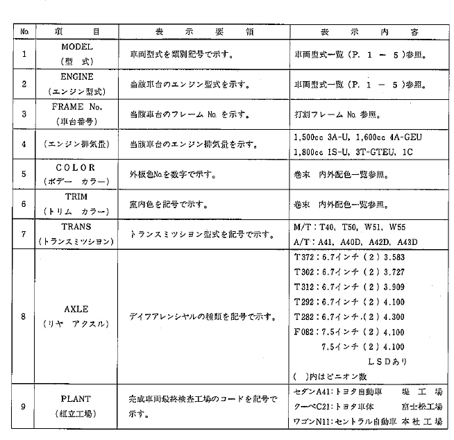

Finally found the information I was looking for.
Basically this table got all the options for the Carina axles:
So either you have a T292 (4.1) or a T282 (4.3). In the last case it is the exact same code as the non-LSD for the AE86. The T283 axle is the one with LSD.
Still this does not guarantee it is entirely the same as there are differences in mounting points, brakes and zenki/kouki halfshaft differences as well.
