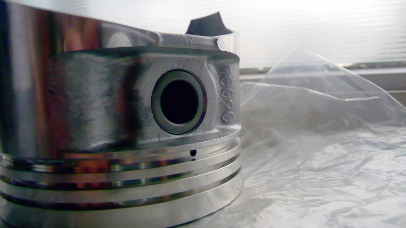

As far as NPR quality is concerned: I'm sure there are quite a few engines running these by now. I've read somewhere that NPR was an OEM supplier, and if I had to judge by looks, I would believe it immediately. They are exact up to the markings cast into the pistons.. only difference between the NPR's and original is the lack of 'toyota' down the sides (the 16020 is there on both OEM and NPR pistons in the same font).
Just judging by appearances I dont see any reason to distrust the NPR pistons. They have the same weak-point as OEM: the oil slot beneath the oil rings. There is a minute difference in machining at the ends.. the OEM 16030's have a wider end-hole on that slot, the NPR's dont, which is probably better. This is a weak point because the ringlands always break somewhere along that slot (when they break.. took my 1st bluetop 300.000 km's).

as promised, some side by side pics.
Excuse the quality, light conditions in the evening arent great.
16020 9.4:1 on the left.
16030 10.1:1 on the right.
