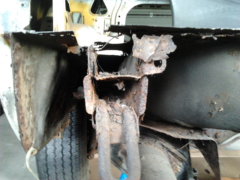

I see you took the backpanel out. Do you have a replacement or just going to fix up the old one?

I was planning to repair the old rear panel. Also because the original from the dealer is no longer available, otherwise it would be too expensive: P The bottom of the back panel had already been badly repaired. So that's why I only chose him to be removed.

I saw that te backpanel for the coupe is not available yet. And the origial panal is repairable, nothing a weldingmachine can't repair Smile

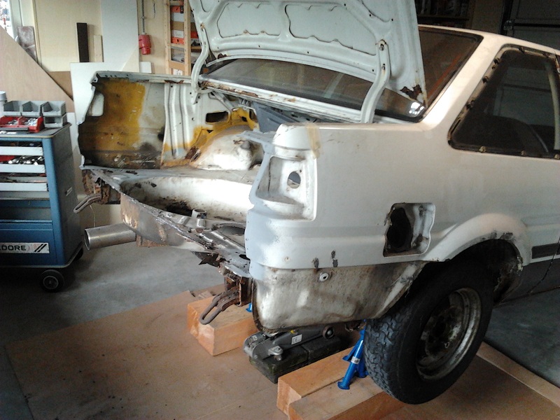

It was a little bit quiet here in this topic, because i was working on the car.
Luckly i made some pics of the work. The welding on the back end is almost done. In the next weeks i wil start the welding on the wheel arches.

look good! Thumbs up! what a welding skill
