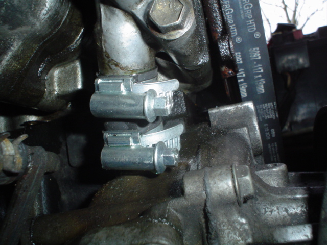

Transfer the water pump and all its pipe work it should all come off 4AGE as one piece with three 12mm (15nm) bolts on the front of the block, use the seal from the 7AFE pump as it is probably a bit newer, clean the mating faces. The pipe support bracket on the side of the engine block cannot be used I just left it as it seemed secure enough you could make a simple bracket to hold it.
The water pump to head pipe needs to be extended, just cut it in half put the 3/4inch hose over, you only need about 5cm and clamp with two jubilee clips.

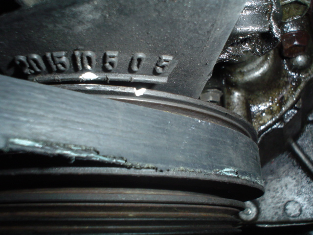

Fit adjustable timing pulleys, firstly mark them against the original pullys for the original timing marks. make marks on the new pulleys by drilling a shallow 3mm hole where the timing mark should be (the same place and fashion as on the original 4AGE ones (the small indent on the rim) check the right one is on the right side as they are different see manual for orientation
Fit the lower timing belt pulley from the 4AGE engine to the crankshaft
Line all the timing marks up then fit Porsche 944 timing belt, re adjust the tensioner to take up the slack
The lower timing belt cover from 4AGE needs to be modified to fit, look at it from the back there will be a second outer circle around the hole for the crankshaft just file it out to this outer hole and it will fit nicely
You will notice the camshaft pulley timing marks do no line up correctly when the lower pulley mark is lined up. Use the adjustment on the cam pulleys to retard each camshaft by approximately 3-4 degrees to so it all lines up nicely
