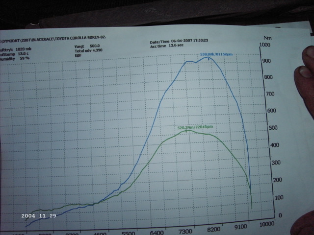

It is a stock 4agze 145hp bottom, very modyfied head, and Super T70 turbo running megasquirt and 2,1 bar....
He just made 559 hp and 520nm today....
Thinking about running more boost, but how much boost/hp can you put on crank?..

04-08-2007, 12:04 PM
4agte new record in denmark
crazy power for a std 4ag whatever you have done to it! unless the bottom end gets work done to it to compliment that kinda power output its only a matter of when its gonna shit itself!
whats with the bad flat spot at about 7700rpm???
also, with that kinda torque gearboxes, diffs etc are gonna be a serious issue!! be prepared to take a long step back and re think or else get the cheque book out.

04-08-2007, 05:01 PM
Ian - AE86 Wrote:crazy power for a std 4ag whatever you have done to it! unless the bottom end gets work done to it to compliment that kinda power output its only a matter of when its gonna shit itself!
Good job though! savage power for a 1600 in any mans language. Smile
The flat spot is because it just hit overboost, didn,t bring my computer, so we couldn't change it...
Well never mind about gearbox and that, just wana know if we need speciel crank if we go past 600 hp...
