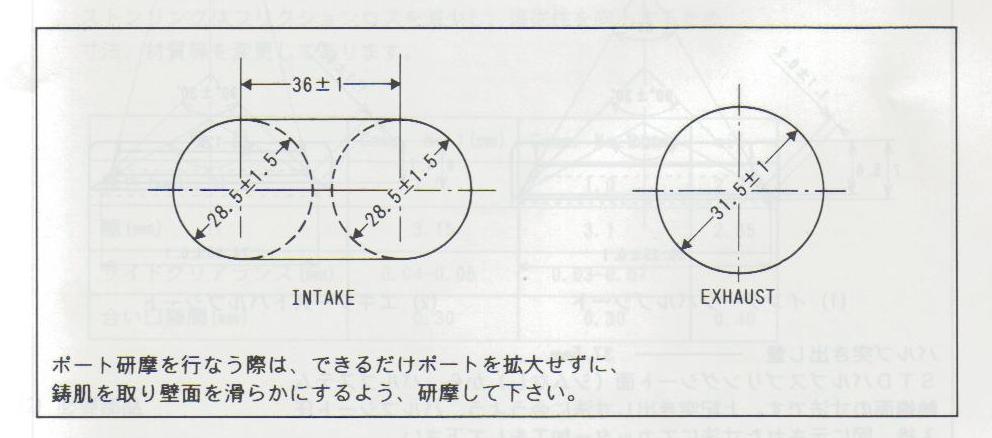

What is tragic is that i measured big port once and manifold was great, but i lost the measures. Now I want to try smallport head, but since it is just on the way, i still don't have it, I'm trying to find dimensions and to have manifold ready when head arrives.

well don't know if you need more info than that but here goes... freshly out of the bible (dimensions of the smallport) Smile[Image: AEU86 AE86 - 4age intake side (port) dimensions]

For AE92: yes
but I am pretty sure this is for bigport Tongue

bigport has ~15mm radius in the corners as far as I'm concerned...
but feel free to post measurments if you have.
the radius on bigport / smallport are pretty much the same Wink
The difference is the length of the port
bigport is around 65mm when smallport is around 52mm
Anyway I will give the exact size after my work Tongue

It looks that fixing point are the same, and that biger ports are bigger to one side.
Could be even the same height, so just center point and width is the same.
