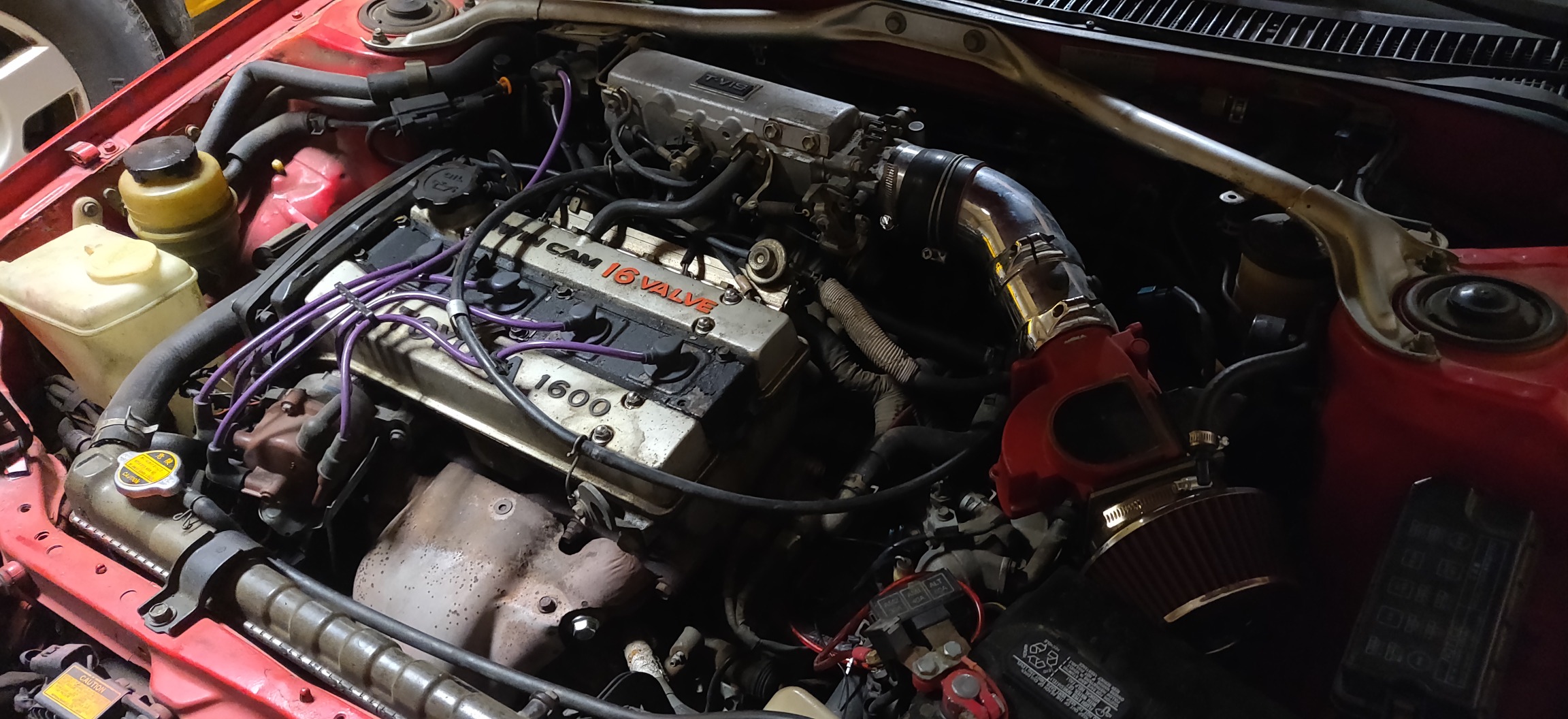

Did my engine ever feature in an AE92?

Alex170984 Wrote:Did my engine ever feature in an AE92?probably, one from the early years. AE86 ex-daily |
