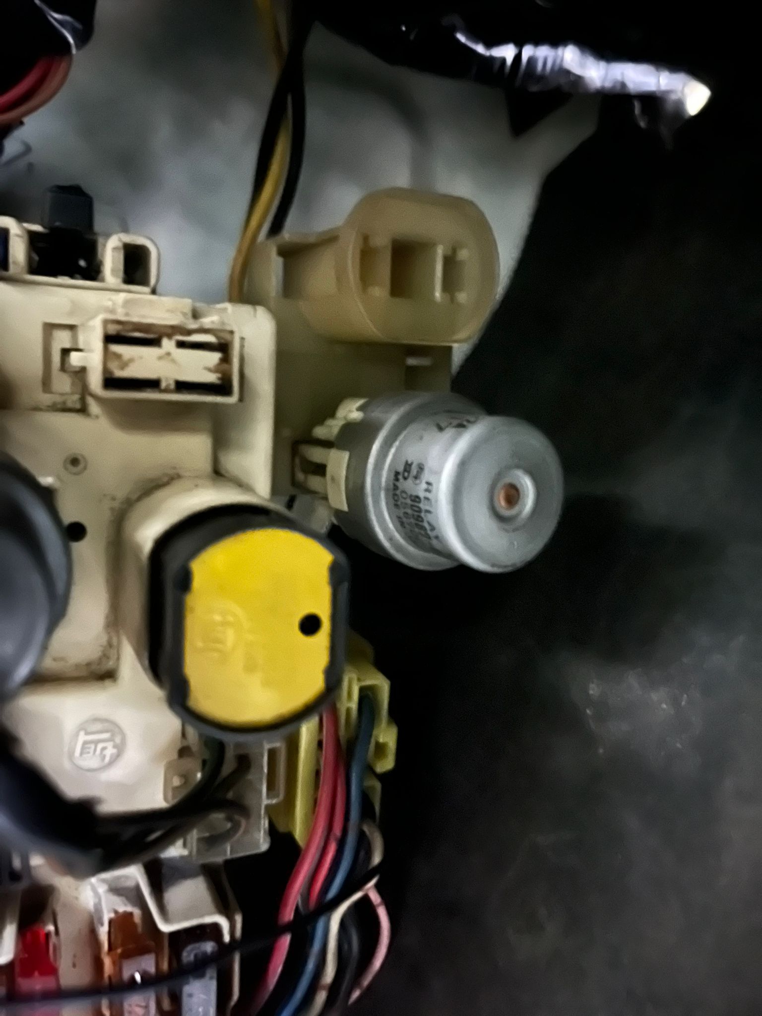

I'm providing the positive 12v from the yellow wire located in the driver side fuse box, controller by a relay grounded to the chassis, so it powers on only with the key in the On/Start position. The ground is provided by the ECU with a yellow and pale green wires connected to the #10 and #20 pin.

If i manually ground these pin i can hear the injectors click.

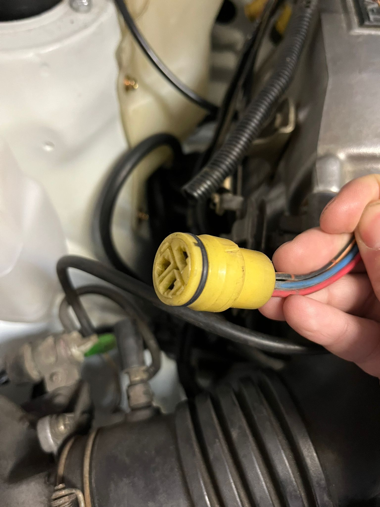

While looking for the injectors wires i found that the positive feed was finishing in a round plug with 3 wires, one of them with a +12v with the key in On position.
Sniffing around a lot of forums i figured out that is the resistor pack connector and, while for early blue top MAP sensored engine is not needed, apparently for AFM sensored car (like USDM), is needed.

I believe my options are, form what i've seen in other discussion, source a resistor pack or use some high impedance injectors.
Can someone confirm that i am down the right track and not messing everything up?

I believe you are correct. Either way you solve it will work, I imagine the resistor pack is not very specific to the AE86 so I'd look around for other more common models that may have had one.Off course you will need to short some pins to bypass the resistor pack if you decide to go with the high Z injectors.

Thanks Ivan! I ended up purchasing a resistor pack from a mk1 aw11 US version, that i believe it should be an almost perfect match. Even the connector is the same. Now i'm patiently waiting for it to arrive!
