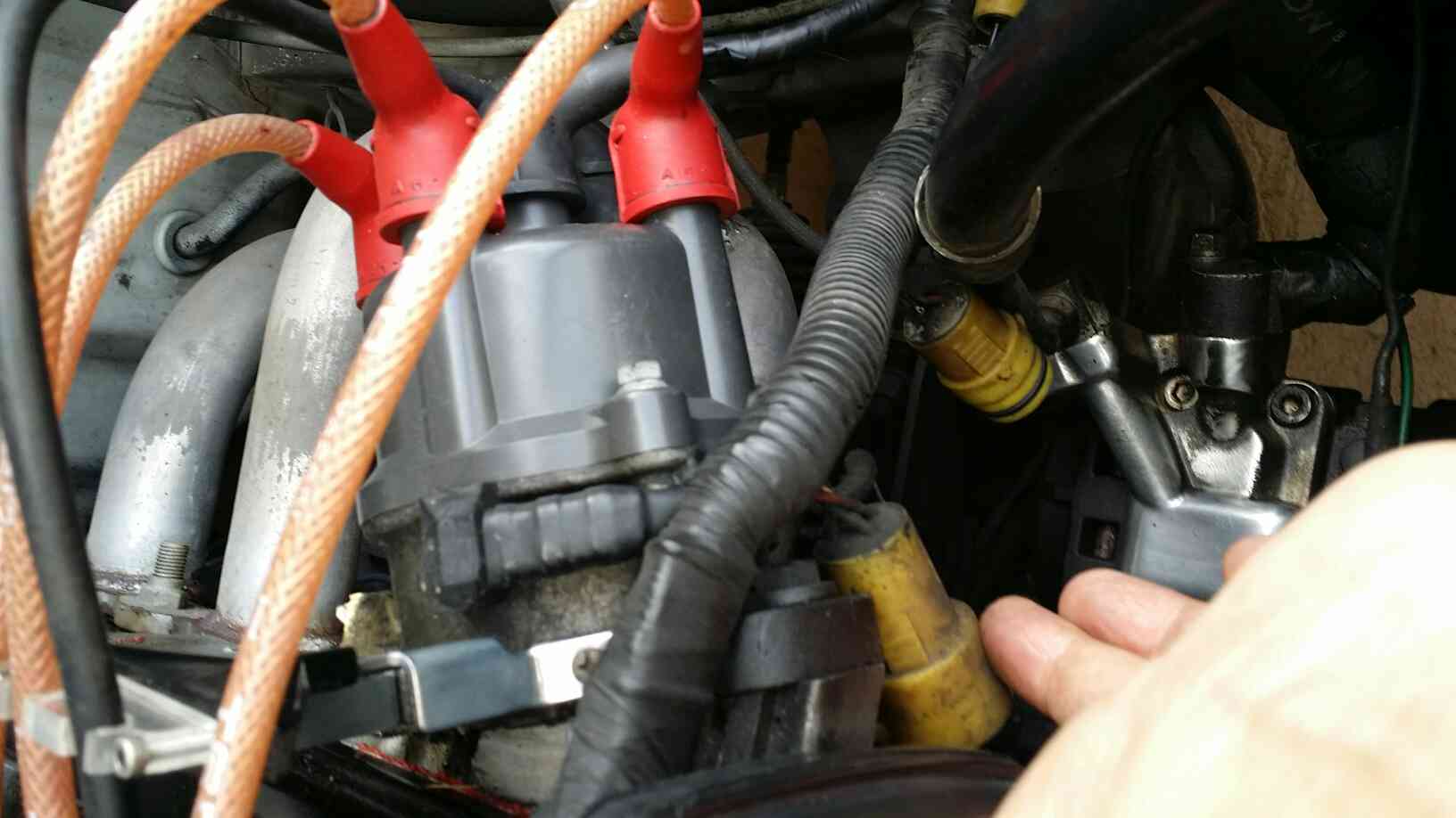

Base on the repair manual check parts by parts. Finally is only 01 signal cable from distributer send back to ECU broken, from the cable condition is mainly due to high temperature surrounding and the cable rubber become plastic and fragile. (Refer photo as the BLACK cavle broken and other 2 coming soon)[Image: AEU86 AE86 - 4AGE 16V engine overheat wh...high speed]
After reconnect the cable (all 3). Test the Ohm signal send back to ECU and all within specification. Test start..... "she" alive...
For this case. I also have replace and recheck lot of related item and gained more knowledge on this 4AGE... thanks...
Anyway. I plan to replace the distribute signal cable with new, but have no idea what cable size i need for it. Any suggestion.
Thank you

You can pry off the back side of the yellow plug. Trim the current wire ends, and re-attached the wires to the spades. Carefully remove the old ends of the wires from the spades. Then, re-bend the prongs, on to the newly cut ends, and then add a new solder to each of the connections. Finally seal the connector plug with RTV inside the plug, before pushing the back of the connector back into place.
[good for another 25 yrs.]

If I remember correctly it's a 16 gauge wire.
You might want to consider a heat shield or wrap the header to lower the temperature in that area

The length of wiring outside the conduit is too short to provide sufficient
flexibility to prevent the wires failing from fatigue. After that heavy plug has
jiggled around a few million times it can fail where it joins to the plug. If the
cover on the wire is stripped back for a soldered join that creates a weak
spot due to lack of support for the copper wire.
There should have been a larger loop of cable there to spread the flexing.
Even with the soft braided sheath used on the factory wiring failures can
occur at the point where the wires enter the distributor. That is where the
wires are subject to maximum bending as the cable flexes with the movement
of the car. Rare, but it does happen.

If you are concerned about the wiring outside the distributor being to short, not allowing flexibility, which could lead to a fatigue failure. You can add a support/heat shield. I used one of the distributor hold down bolts to attach a small heat shield , then add padding and tie-wrapped the plugs to the shield. That way the short wires are not carrying all the harass wt.
Dave W

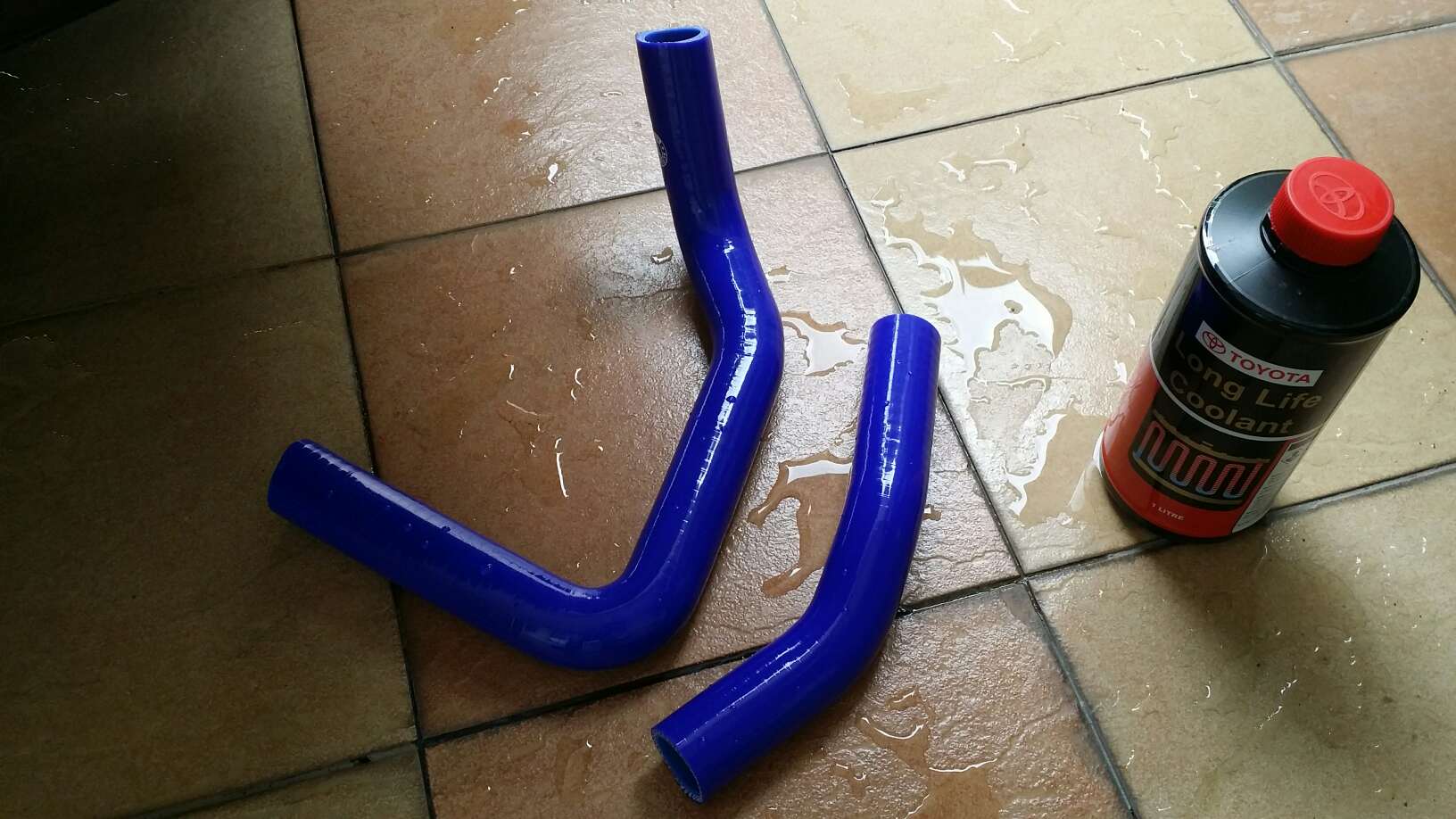

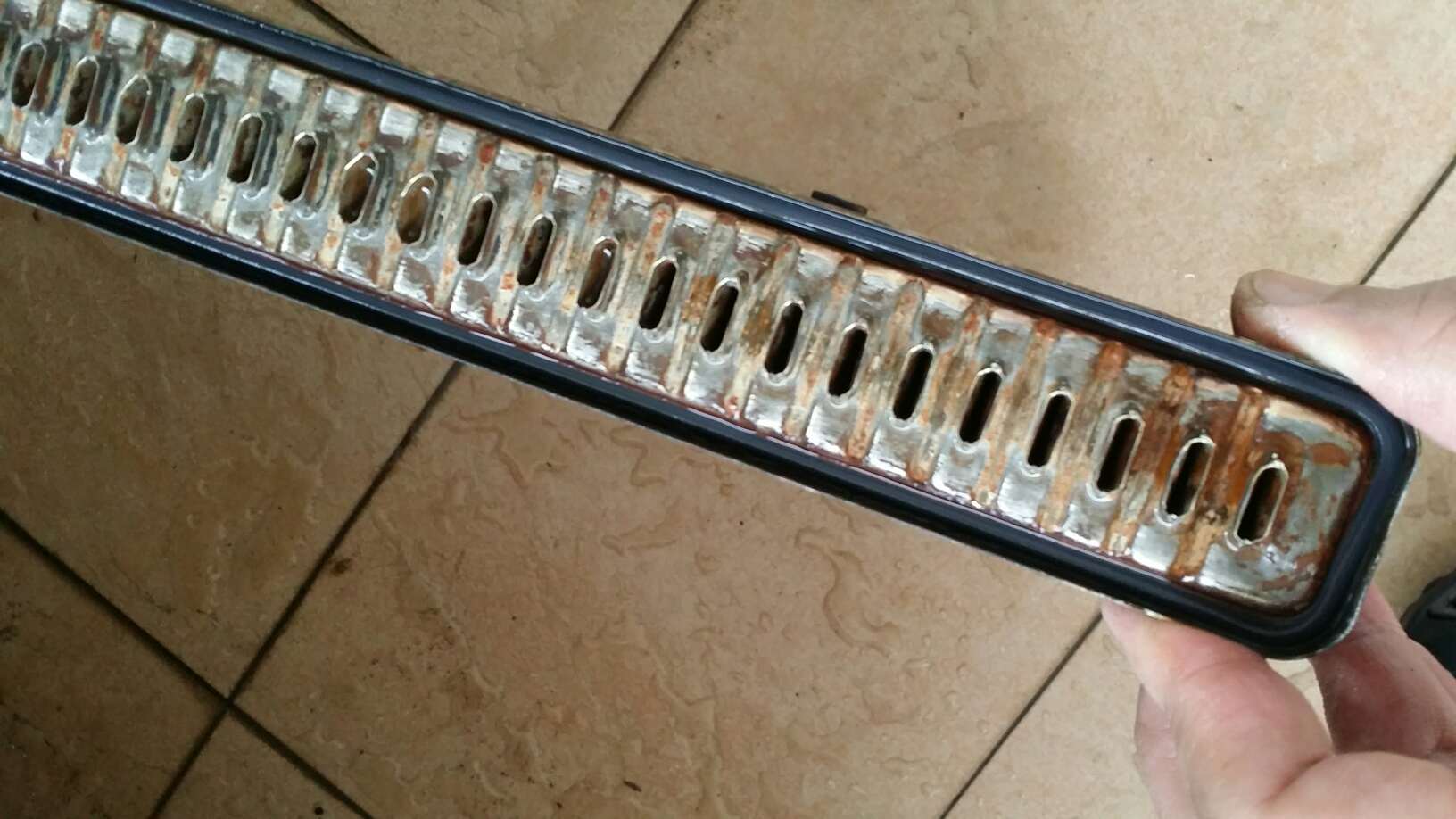

just to update on the my engine overheat issue. Finally have sufficient free time to dismantle the radiator and DIY overhaul service, found that the inside serious blocked and it might due to i recently had done the "scale" wash in engine cooling system with chemical, all the dirt clog at radiator.[Image: AEU86 AE86 - 4AGE 16V engine overheat wh...high speed]
after 1 by 1 slot clear, reinstall with new thermostat and radiator hose. Test run and found no more overheat issue, now the temperature always at 1/3 of the gauge although i at high speed.
so as conclusion that all above issue is due to radiator clog. thanks allot on the ideal and suggestion from the member. love u guys. tqvm
