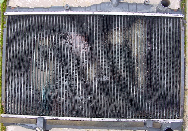

If you can get some Forte coolant flush (or whichever brand you prefer) then its probably worth it too given the age of the car.
Perhaps check if the radiator is blocked, but if it just has a few bent fins then it won't make a noticeable difference, hell here's the radiator from my old 86 and that car wasn't overheating.
[Image: AEU86 AE86 - 4AGE 16V engine overheat wh...high speed]

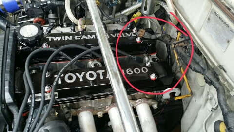

Dear jondee86.
Today check again on the 4age 16v RWD. for the timing belt is still at the place that it. No jump teeth found (refer attachment photo)
But i found that ignition cable 1 and 4 with totally no ohms on it (sound funny due 2 cable in same time?)and had replace all the ignition cable to new. Test start result remain. Totally cant start at all.

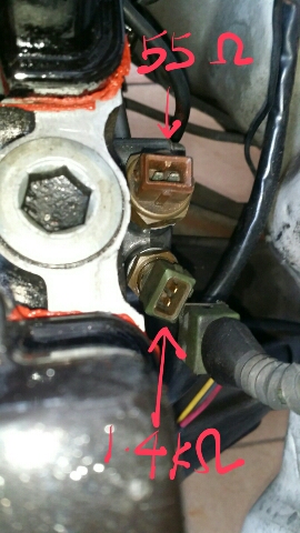

Did u guys know how many ohms that this 2 water sensor will send out? Location of sensor as below photo.
Current check 1 is 1.4k ohms and 1 is 55 ohm. Suspect the 55 ohm sensor might not as per specification due found it housing was broken.
Plz do advise if this sensor malfunction, will the engine also cant start? Tqvm
