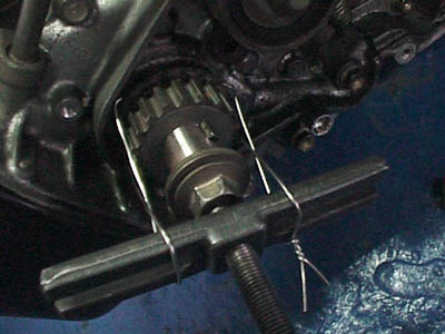

Ivan141 Wrote:Sad to say it isnt all that simple. Getting the crankpulley off that way is not the best way and often doesnt work at all. Getting the timing belt cog of of the crank is also almost impossible. That's where I am stuck with my old 4age, it cant be 'levered' off. I cant find a puller that fits and wont damage it either.
Ivan, maybe this is the solution to your problem:
