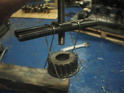

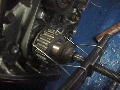

Ivan141 Wrote:Sad to say it isnt all that simple. Getting the crankpulley off that way is not the best way and often doesnt work at all. Getting the timing belt cog of of the crank is also almost impossible. That's where I am stuck with my old 4age, it cant be 'levered' off. I cant find a puller that fits and wont damage it either.
Ivan, maybe this is the solution to your problem:
11-09-2004, 05:45 PM
4A-GE head work
That's brilliant Zax! I'll see if I can find a puller like that and some heavy duty steel wire.

Most ordinary pullers wont fit. I tried a small one but it damaged the cog so I stopped trying. I have to rent those damn pullers, so I'll probably end up making one myself this time.

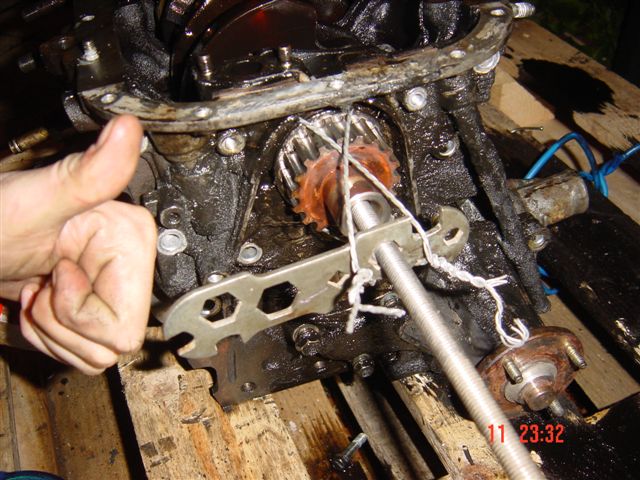

2 zax: i tried today to do it, it didnt move Sad
[Image: AEU86 AE86 - 4A-GE head work]RX-8[Image: AEU86 AE86 - 4A-GE head work] -- AE86 --
11-12-2004, 12:07 AM
4A-GE head work
Use bigger hammer! Tongue
Try using thicker "bicycle key" like the Taka on my pictures.

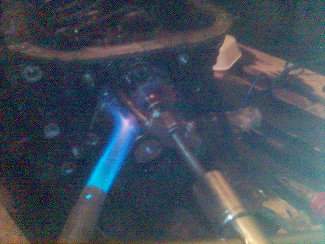

How much damage could heating that cog up with a blowtorch do?

Yesterday i manage to take it off.... Thumbs up!
