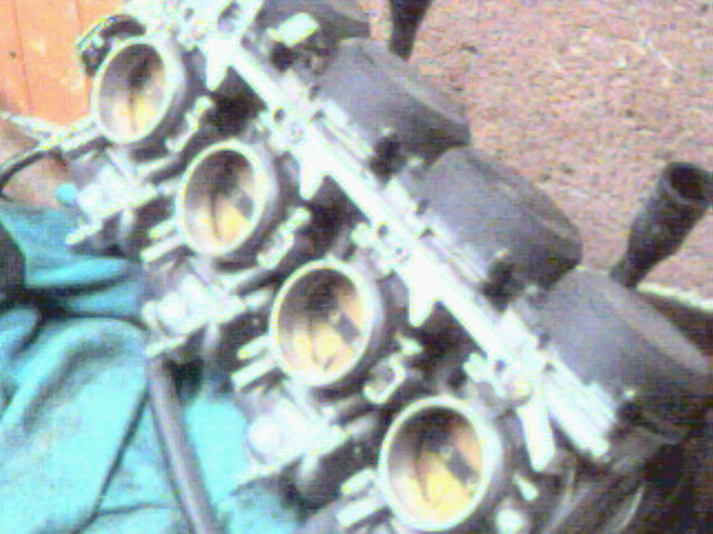

I've found carbs from Kawasaki ZX-9R, 10 000km. Bike is destroyed.
Carbs are keihin G314 AKKL with 40mm inner diameter.
We've calculated that flow on 900ccm engine on 14k rpm is same as 4a-ge small port on 6,6k rpm so it should be ideal in terms of sizing.

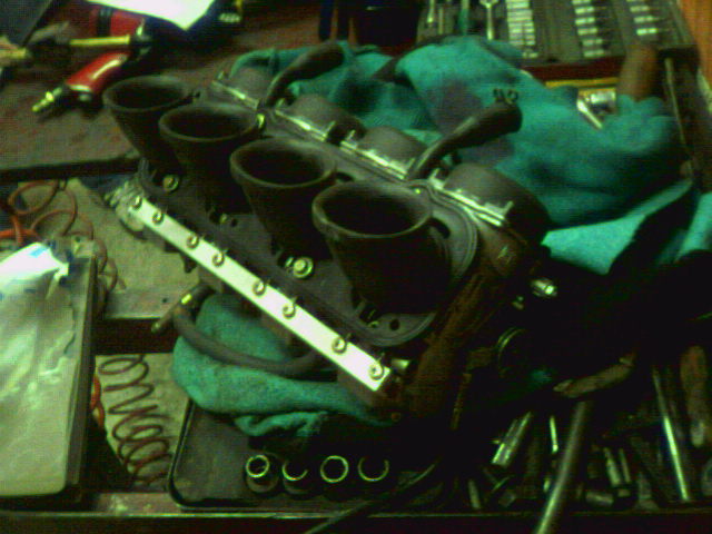

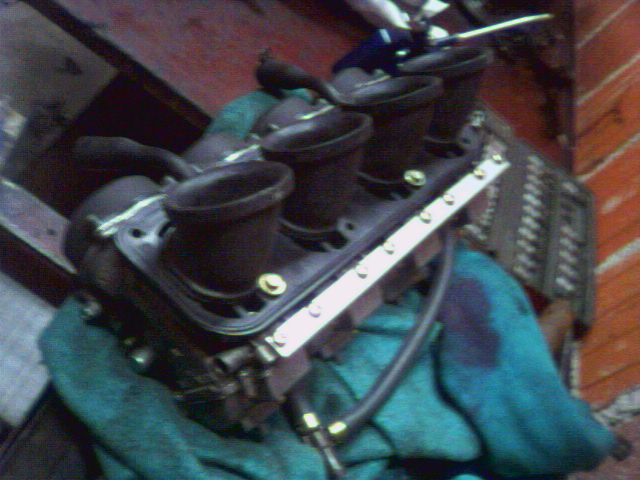

I might try this setup, but the bike-guy says i have to run'em with airbox on. Since i would like to run them with trumpets/KN filters is there any problem with that, since these carbs need vacuum to work properly.
PLEASE SOME OPINIONS since it's kinda urgent.
I need to buy or return these babies.

nice thoughts you have! where do these carbs need vacuum??? (afaik this equeal-pressure thing is made internaly. no need for airbox ...)

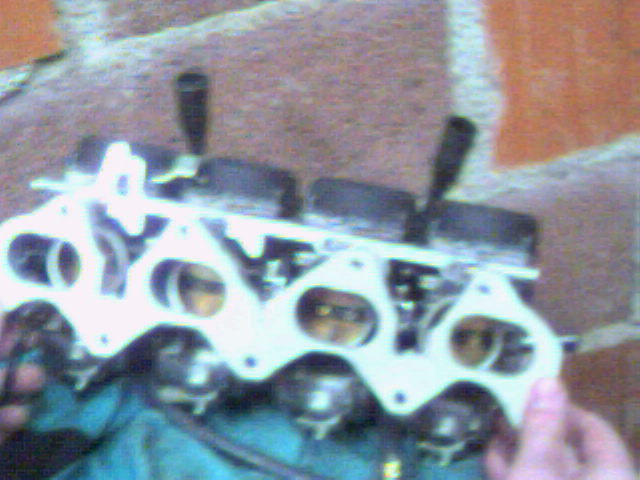

There will be no problem with vacuums :-)
But adapter seems to be big2smallport - I think that you will need additional (or new) one.

you guys are all wrong -' These are VACUM carbs - they need preassurized airbox

Zax better not try this i think getting them to work is not managable for what you want with it.
What would your ecu do ???

I gave up on these.
To much problems to make them work properly.
