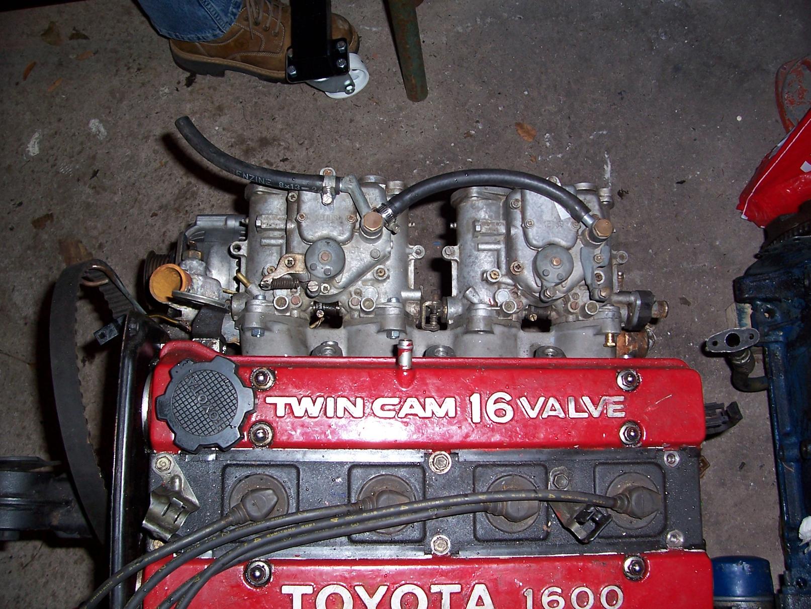

01-31-2005, 11:45 PM
4A-GE + CARB
these carbs are mounted on the engine that i bought this weekend
