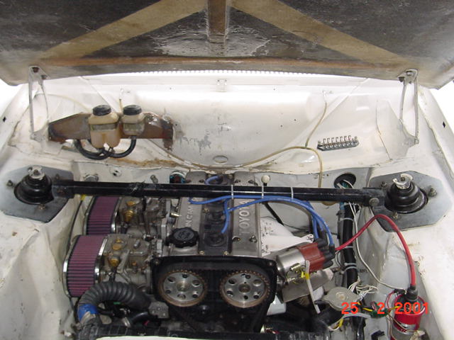

something like this

I'm also interested in carburettors fitting on my 4age.
Probably Weber 45Dcoe , or 40DCOE , but I was wondering how I could get ignition.Some told me it was possible to keep ecu for ignition only , but don't know how . The other solution is to fit another distributor and coil , but what model car should it come from?I was told to use an old Tercel one, but pignon must be reversed , and some work on automatic advance is to be done to!
Any one experienced that mod ( I also plan to add camshafts to gain a little power)
